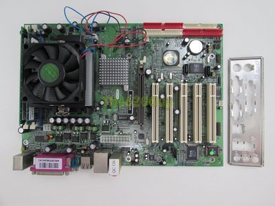

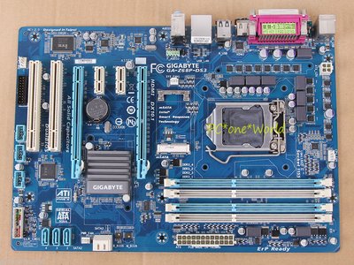

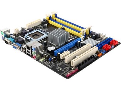

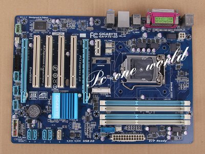

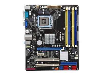

First post, by Intel486dx33
Which supports Sata drives and which is bests for Gaming ?
I want to build a 775 Core-2-Quad gaming computer and install Win 98 , ME or 2000 with Sata drive support.
Or should I just use an IDE to Compact flash adapter ?
What about an SSD ?
I want to make it a Media computer with Terratec Audio cards that are only supported in Win 98/NT2000/XP.
What do you think is the best mobo for this?
775 Core-2-Quad or 1155 i5-3470 ?
I am looking at Gigabyte Mobo's

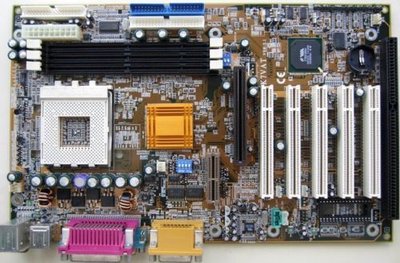

Reply 1 of 16, by Intel486dx33
Since I want to use Terratec cards with ISA and PCI it looks like I am stuck with a P3 1ghz mobo running Win98se or ME or Win2000
Which OS do you think is best out of these ?

Reply 2 of 16, by keenmaster486
You'd be better off with a Pentium 4 motherboard, one that still has ISA slots, or maybe Socket A with ISA, and Windows XP.
World's foremost 486 enjoyer.

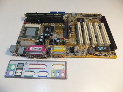

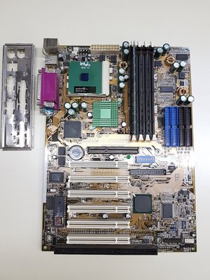

Reply 4 of 16, by Intel486dx33
Okay, Yeah I found this AMD Socket A board that supports up to 1200ghz Athlon CPU.
Or I can choose a Intel BX 440 Mobo Socket 370 that Supports 1.4ghz. P3 Tualatin CPU.
P4 mobo with ISA slots are rare and expensive.
What do you think ?
Which to choose ?
I want a good Mobo because I plan on using some high end expensive cards.
Use is Terratec Audio and Media Creation Studio and light Gaming.

Reply 5 of 16, by cyclone3d
You can always go with an Industrial type setup (backplane + SBC) to get PCI+ISA.. but unless you get a PIAGP setup, you will be limited to PCI video. Either way, you would still be stuck on Socket 478.. up to 3.4Ghz single core with HT. The SBCs include an ITE8888 ISA bridge with full ISA support including DMA. You can get backplanes with up to 20 expansion slots.
As far as the highest speed that still has an ISA slot that has DMA support without resorting to super expensive S478 or LGA775 ATX boards, you can go with an Abit KT7A or KT7A RAID.
With a modded BIOS and most likely new capacitors, you can run a Athlon XP Mobile CPU at about 2.4Ghz with a CPU socket wire mod to enable/switch to the higher multipler to get to that speed.
SSDs rock. You have a SATA controller, use an SSD. If the board doesn't have SATA built in and you have PCI slots, get a Promise S150 SATA 1 RAID card as there are drivers for Win9x.

Reply 6 of 16, by Intel486dx33
So out of the two , Which would you choose ?
1) AMD K7VAT VIA KT133 SOCKET 462 Socket A board that supports up to 1200ghz Athlon CPU.
Or
2) VIA Apollo Pro133T 596B Mobo Socket 370 that Supports 1.4ghz. P3 Tualatin CPU.

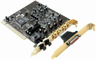

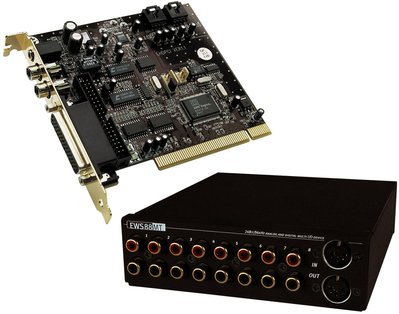

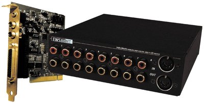

Reply 9 of 16, by Intel486dx33

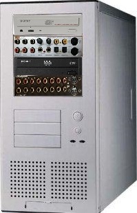

Yeah, It's going to be a retro Audio Studio build with Terratec audio cards. One ISA and TWO PCI cards.
Oh, wait. They are all PCI cards. In which case I can go with Socket 755 Core-2-Quad or 1155 i5-3470 CPU.
Or AMD.
What do you think ?

Reply 14 of 16, by PKFreeZZy
Depends on what range of games withing a period you want to play on it.
Note that if you want a Windows 9x PC, go with Windows 98. 95 is fine but somewhat lacky and doesn't excel at driver support with newer hardware that claim to be compatible.ME is pretty much Windows 98 Plus! on a single CD with bonus crashes. You'll also need a MoBo with IDE ports or a PCI IDE controller because the 9x's are incapable of being set up from SATA optical drives. Remember, none of the 9x OSes support SMP, so if you go with the Core 2 Quad not only is most of its power wasted, it's also going to have to be paired with a GPU that's supported under your 9x OS, and yes, SSD's will work.
Win2K and XP DO support multiple cores and threads, however the former may still be unable to install from a SATA drive, according to my experience. XP is definitely your go-to option here because it's fully compatible with your LGA775 motherboard and supports a wide range of graphics cards.
If you really want to build a Windows 98 gaming PC, look no further than the Pentium 4 or Athlon series. In my experience, Slot 1 systems with the 440BX chipset are the best for this era.
