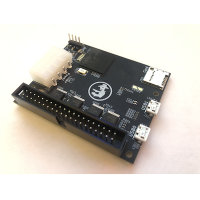

Here ya go:
https://shop.tattiebogle.net/product/prod_EkTnv3Tk2Trxhf
Supports audio as well.
Only $200

Reply 48 of 61, by cyclone3d
I am betting the hardware emulator I linked earlier does the CD-DA extraction and conversion in real time, hence the 180Mhz cortex CPU.

Reply 53 of 61, by cyclone3d
Deksor wrote on 2021-08-18, 05:50:

Reply 54 of 61, by Deksor
Yeah ... Although this may be a bit too expensive for most people. I think something cheaper can be made
