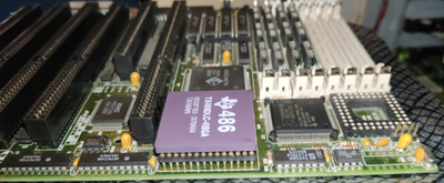

My board is the same model and revision. It has an Am386DX-40 Revision D -PQFP-CPU. My board also came without the PGA 132 socket. I soldered in a PGA 132 socket. This is my board, PGA132 soldered in, 486DLC plugged in:

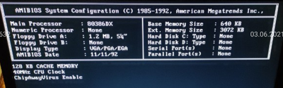

Without the 486DLC in the PGA 132 socket the board detects the 386DX CPU:
710.21 KiB
125 views
The 386DX gets mildy warm and everything seems stable.

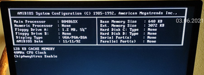

When I plug in the 486DLC the board detects a 486SX CPU (see screenshot):
811.21 KiB
125 views
Now this is where the problems start: with the 486DLX plugged in, the board only boots sometimes. It takes a couple of tries (power on/ off).
In any case (whether it boots or not): The 386DX gets dangerously hot within seconds.

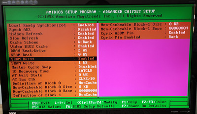

One more thing, the only correct DLC cache setup that works in BIOS is to set A20 mask to enabled and flushing to BARB. A20M is connected, sort of, it's provided by the keyboard controller (and that's all it used for it seems, the actual gating is done inside chipset) so do not enable fast A20 gate option. If you set A20 mask to disabled BIOS will configure the CPU to not cache first 64k of each 1MB region, that's perfomance loss and the mask signal is connected after all. Nothing else is though so BARB is the only option (do remember to set RAM refresh to hidden). While it might seem like FLUSH works too, it's only because most of the time the small L1 is evicted before it has a chance to cause collision. But it can randomly corrupt CPU state. Well, if you are going to do FLT mod then you can also add hardware for FLUSH too - I plan on doing that.

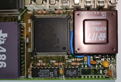

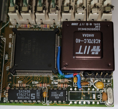

I did a quick test. I connected pin 54(FLT) with pin 55 on the 386DX without disconnecting pin 54 from its pad. I simply put a small piece of copper wire between the pins and voilà:
1.57 MiB
74 views

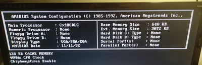

This time the board didn't detect a 486SX. It detected a Cx486DLC. Interesting.
Also, with the wire between pin 54 and 55 installed the 386DX doesn't get violenly hot anymore. It still gets warm but reasonably warm.
I think I will make that unused jumper (JP76) into an FLT ebable/disable jumper just as you suggested.... EDIT: Or maybe I am lazy and I will simply solder pin 54 and 55 together without disconnecting pin 54 from its pad. Thank you very much. I apply the suggested (bios) settings once the mod is done. 😀

OK. I modded the board as suggested by Deunan:
1.09 MiB
43 views
927 KiB
43 views
I installed a jumper for JP76. I connected the 386DX's pin 54 (FLT) to Pin 4 of the (missing) U99-IC. (The U99 CLK-generator-IC is missing in my board. It uses the CLK-generator in U35 instead.) Pin 4 of U99 has a trace to JP76. The other Pin of JP76 is connected to GND. JP76 is now te enable/disable-jumper for the 386DX.
@Deunan: You wrote that"...the only correct DLC cache setup that works in BIOS is to set A20 mask to enabled and flushing to BARB." By "set A20 mask to enabled" do you mean that I shoud set the Bios option "Cyrix A20M Pin" to enabled? :
1.16 MiB
39 views
