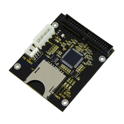

I recently got one of these SD to CF adapters ('Sintechi hightspeed SD to CF adapter v1.0' is that is shows in the BIOS). It works when it is the only thing connected to either of the IDE cables, but as soon as I want to introduce anything else I.e. CD drive, into the mix those items I add can not be seen.
For example:
SD to CF on IDE 1
CD set to master and on IDE 2 - Not visible
CD set to slave and on IDE 2 - Not visible
CD set to slave and on IDE 1 - Not visible
SD to CF on IDE 2
CD set to master and on IDE 1 - Not visible
Remove SD to CF
CD set to master and on IDE 2 - visible
CD set to slave and on IDE 2 - visible
CD set to slave and on IDE 1 - visible
CD set to master and on IDE 1 - visible
Nothing else will work on either IDE channel if the SD to CF adapter is being used. As soon as I disconnect teh SD to CF adapter everything else works first time.
I tried with multiple drives, all with the same result. The adapter does not have any jumper settings which might be part of the problem. I'm using a Gigabyte GA-6BXC if that is any help.
Does anyone know of a SD to CF that will actually place nice with other components that I can get in the UK? One that I can easily mount in the case would be a bonus. I don't want to get another random one in case I waste more time/money and have the same issue again.
Thanks for any help.

Reply 8 of 13, by the-beast
OK, old thread however I think I've finally solved it.
As I have been testing various boards over the years it became apparent it was working fine (with what I had) on every motherboard except Gigabyte boards.
I noticed a few other people had ones with a firmware version of 'Sintechi hightspeed SD to CF adapter v1.2' on youtube so decided to take small risk and ordered another one. It arrived the other day and externally looks exactly like the old one down to the SD35VC0 marking. The big difference was this was showing on boot as 'FC-1307 SD to CF Adapter V1.4' and even better it worked.
So in answer to my question from 4 and a bit years ago yes a SD card reader adapter can work with other IDE devices plugged in but only when using newer adapter firmware on Gigabyte boards.
How I'm wondering if I can update the firmware on my old adapter.

Reply 12 of 13, by weedeewee
the-beast wrote on 2023-04-03, 17:23:
OK, old thread however I think I've finally solved it. […]
https://imgur.com/a/6LfT5tS
I think the IC containing the firmware is the small 8 legged ( SOIC-8 ? ) one FH25VQ40 .
I think it's a 4 Megabit Serial Flash Memory.
At least the closest resembling datasheet makes me think that.
