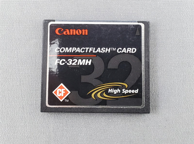

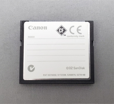

This topic made me curious to dig out the oldest Compact Flash card I believe I have.
It's a 32MB Canon-branded SanDisk card. It originally came with a Canon PowerShot camera I got in 2004. The back label even has a 2002 copyright date.

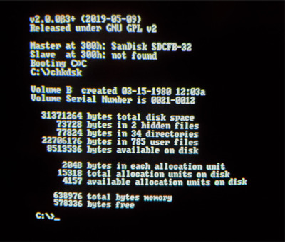

About 2 years ago I set it up as storage in a Tandy 1000 HX computer. That Tandy computer has been in my closet for over a year.
I just took it out, powered it on, and it booted up just fine. Ran check disk and it reported no issues. Tried playing some games and it seems to be working just fine.
I realize this is only a single piece of anecdotal evidence, but it is still a 20 year old CF card that is working today without noticeable issues.

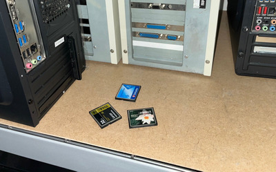

Similarly, attached a random photo of some CF cards that I'm talking about.

I understand this is very frustrating. I'm not trying to accuse you of doing anything wrong necessarily, I just want to rule out potential causes of these issues you are having. It is unusual to have multiple cards die especially from non-use.
It could just be bad luck, maybe bad batches of cards, or maybe there is some other factor?
I haven't used those Kingston or Lexar cards. I've have used Verbatim cards since 2022 without issues. One of the cards I use as my main test bench drives is a 4GB Verbatim branded card. I figure if any card I have is going to die, it's that one since it's the one I use the most. But I've used it extensively with no issues thus far.

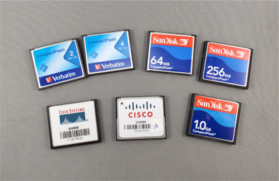

I've attached a picture of the main card brands I use. I stick to Cisco branded industrial cards and the red-blue label SanDisk cards for XT to 486 systems. For Pentium systems I've been using the Verbatim cards. I've got over a dozen CF cards that I've set up and used in various builds.
282.3 KiB
453 views
I also have a collection of other branded cards, but I haven't tested them extensively. I did try a Wintec card once, but while it worked, it also was incredibly slow compared to similar SanDisk cards.
A lot of the smaller cards I bought in used lots, so they already have some wear 'n tear on them. But they generally have worked, at least insofar as the SanDisk and Cisco cards go.
