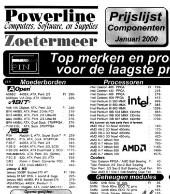

Btw, probably one of the reasons why these ASUS P2B-DS boards are not common today is their original price tag. Here a scan from a dutch catalogue january 2000 where it is listed for Fl. 1.175 => +3x what you would need to lay out for an ASUS P3B-F.
