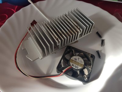

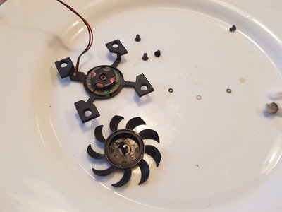

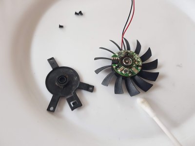

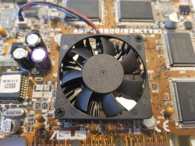

i always like to build an authentic config - but many times the original coolers are buzzing, noisy, stucked, etc. at a standard fan it is easy to replace, but what could we do at a more special cooler? fix it... previously i always did the well known procedure: lubricate at the axle under the sticker. sometimes it could work, and many times not.
i was curious, i completely disassembled a 5cm old fan. i broke it 😀 then i practiced on more small fans, before i touch the very special vga fans.
basically you just have to get off the small white ring at the end of the axle, then pull the teflon rings, bearings, etc clean up everything, lubricate the axle, the bearings. assembly, that is it 😀 i really don't know, why i did not do that previously. i could fixed dying fans, they work like new.

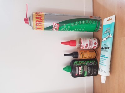

i always repare my bikes, i have more various oils, grease - of course they designed to something else, but the viscosity is very different:
* teflon based spray - very thin, my first choice for the bearings
* teflon based wet/dry oils - they are for the chain, thicker
* rohloff - very thick
* grease - i used just for the axle

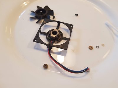

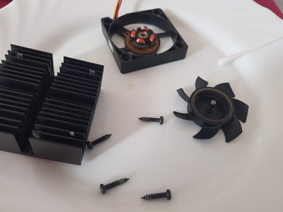

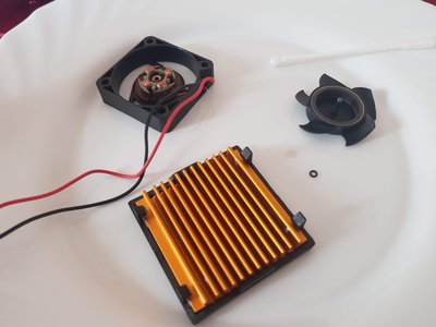

Reply 1 of 16, by arncht

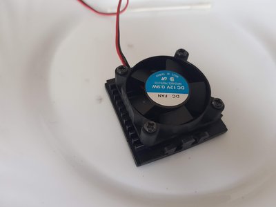

486 coolers - they are very simple, many times they start to buzzing, the normal lubrication did not help. basically no bearings, just an o-ring, at the more "complicated" version teflon rings.
what i have done? some grease on the axle, and after the final assembly, a little thin oil.
they become super smooth - one of them was extremely annoying, not anymore 😀

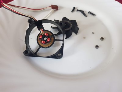

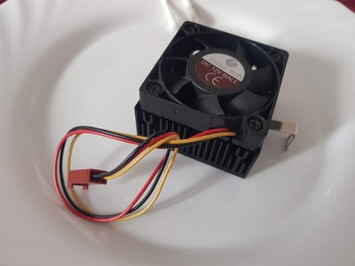

Reply 2 of 16, by arncht

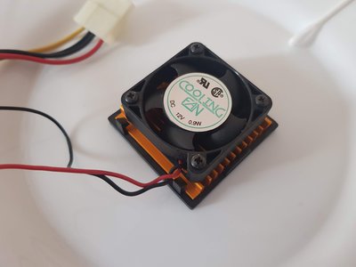

5cm fans from the end of the 90s. they are much better - typically one bearings, i cannot get off the bearing from the axle.
i just used a very thin oil for the bearing, i spin it with a screwdriver, then greasing of the axle.
they left the buzzing, but the noise of the airflow is very loud (this is normal).

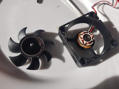

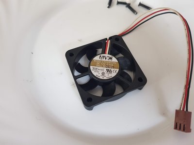

Reply 3 of 16, by arncht
i was surprised, how much better quality 😀 two bearings, a spring for fix the bearings position.
it was easier to lubricate the bearings, and the grease the axle.

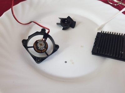

Reply 4 of 16, by arncht

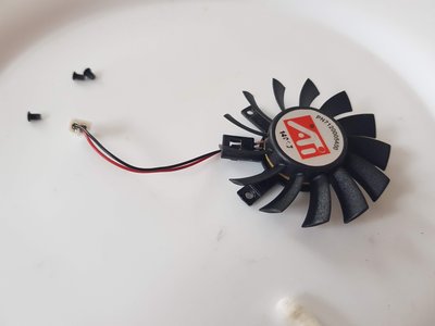

i trained for this cooler... the ati 9800pro fan. they are dying, or died or buzzing etc. i did not know, but it is a very different one.
i get of both sticker, and no axle. i was very sad, i cannot fix it (and damaged the stickers).
i started to strain with a screwdriver around at every gaps. it worked! the basic plate works as a cap. you can put it back easily. i cannot disassemble it better, i tried first with the thinnest oil, it disappeared very fast, then a ticker one. it looked ok.
the result? my buzzing 9800pro is smooth again.

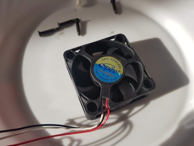

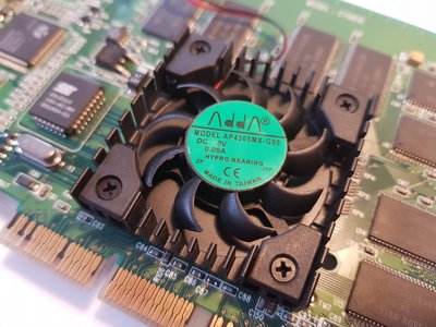

Reply 5 of 16, by arncht
here is two gpu cooler:
tnt2 ultra reference cooler
asus v6600 gf256 cooler
the tnt2u cooler is perfect, the gf256 has some remained mechanical noise. a could not disassemble the asus gf2gts cooler - the closing ring is embedded too deeply.

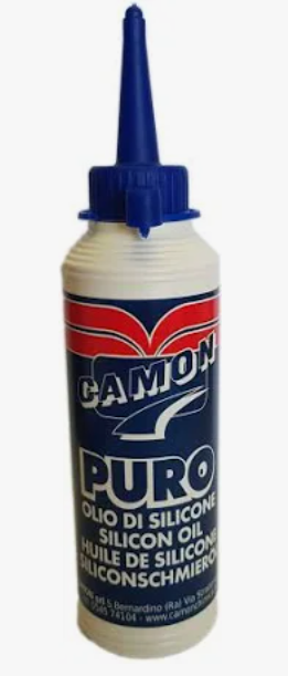

Personally I use regular motor oil or silicone grease for lubricating plain bronze bearings. Oil for smaller, grease for larger ones. A syringe is a helpful tool.
Sintered bronze (self lubricating) and closed (ZZ) ball bearings can be regenerated in hot oil. I usually heat the oil up to whatever max temp it can withstand without starting to break down (depends on the oil, but usually ~200-250 deg C when it comes to synthetic ones), put the bearings in it for an hour or so, and then let it all cool down before taking the bearings out of the oil. The idea is to make the oil less viscous to help penetration, and also make trapped air expand and escape. When it all cools down and the remaining air collapses, the resulting vacuum will suck new oil into the bearing.
I don't mind oil compatibility when it comes to this, since I got no idea what the makers lubricate fan bearings with, and it's a low load and low interface speed application anyways. The latter can be counted in centimeters per second, which is nothing in the context. You basically just want something that prevents metal to metal contact, the oil film's properties aren't all that important.
