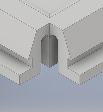

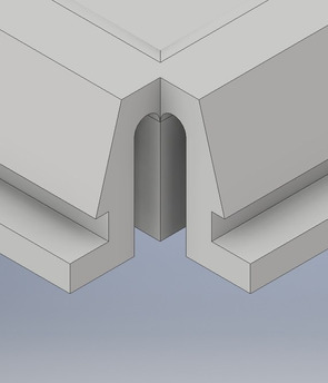

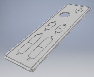

At Thermalwrong's suggestion, I raised the edges of the AT I/O plate a millimeter, to make them more flexible and hopefully work better with PLA.
I did not make the grips smaller though, since there's some I/O plate hole size variance between cases. It's easy enough to sand them down if necessary. Sanding them also gives the additional benefit of a smoother surface without layer ridges, which will make installation easier.
It'll of course also work with other materials. Should be a little bit easier to install than the original version, it might not sit as safely in the case due to the increased flexibility though.
If you print this, please tell me how it worked, and if further adjustments are necessary 😀
Pics with comparison + .STL file attached.

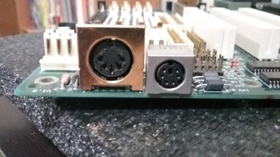

I don't mean to derail, but does anyone have the measurements where the 5 pin din keyboard connector would be on the plate? I have a bunch of blanks and just drilling out the holes would be easier for me.
Reply 44 of 73, by douglar
blackjudas wrote on 2021-01-08, 03:05:
Check out this post-- Download the STL and get the measurements from there--

Or maybe this photo helps--
The above should be more precise, but you can also check this out. It worked fine for me, it's not like you need to drill a perfect fit.

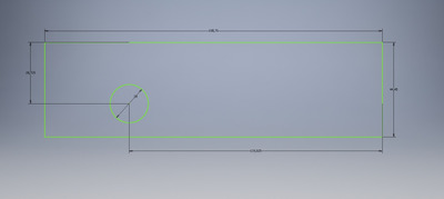

Here are the measurements I used for the AT I/O shield. Using the case aperture as reference:
45.23 KiB
2255 views
Also attached a .dwg. Would recommend printing it to scale on paper, and use as a drilling template.
Sadly, Inventor's export options are quite limited to say the least, exporting as .pdf will just produce a file with an embedded bitmap. No easy way to print that to scale 😜

Reply 55 of 73, by kuenzign

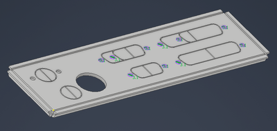

I hope you don't mind kaputnik, but I made some minor changes to your design to add a few more optional ports.
105 KiB
2180 views
I added a second PS/2 port for motherboards that have the PS/2 port soldered on. Like this:
146.8 KiB
2180 views
Additionally, I added the option to replace either a DB25 or a DB9 connector with a DB15 (for a game port). Hopefully others will find this useful like I did. Thank you to kaputnik for creating this in the first place. 😀
    AT IO shield 0.5.zip
    425.98 KiB
    172 downloads

Rather the opposite, I love it. Hope you don't mind me linking it from my original AT shield post in turn 😀

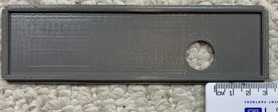

Reply 58 of 73, by Thermalwrong

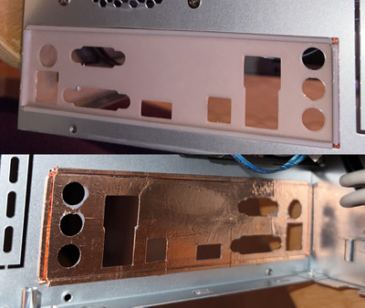

This one's for a modern-ish computer rather than an old one, but I had to make up an I/O shield again. It's printed in PETG so it won't melt easily.
And now it has 50mm copper tape stuck onto it. The copper tape goes a bit past the left/right edges so it can fold over and contact the case. It gives a good ground connection between the ports on the backplate and the case:
