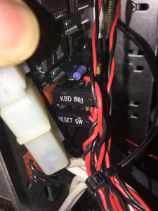

For any Unisys Aquanta HS/6 - ALR 6x6 owners out there who run across this thread I solved a small puzzle with the LCD control panel. One of the machines had a very dim and hard to read display and I could not find any adjustments for it. I started to suspect a failing backlight, but then I took a closer look at the LCD logic board. Lo and behold, behind the KBD and RESET wires on the LCD logic board...

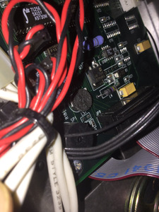

A contrast adjustment wheel.
662.14 KiB
1205 views
Problem solved. Display looks bright and crisp again. Quite hidden from view so thought I would post about it.

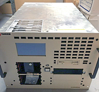

Looks like I am keeping the last one of the five 6x6 floor models after all. There was also a sixth 6x6 rack model that Luckybob has.

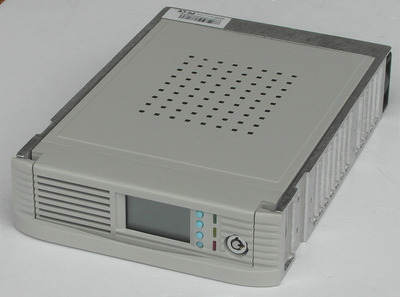

So since that tower is staying, I went hunting for some 80-pin SCA to 68-pin SCSI removable drawers. I already have a couple of 68-pin to 68-pin drawer models. Turns out the SCA to 68 variant is fairly hard to find. Finally found some all aluminum NOS units and they should look nice in the ALR chassis.

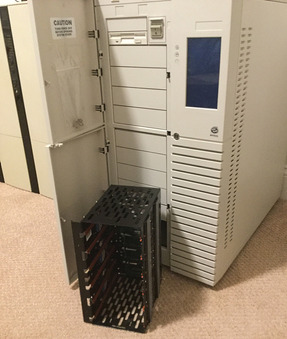

I had a bunch of SCA SCSI drives from the GPPH 2018 (gave away most of them) so I needed these so I could take use of my remaining drives easily. I gave away my two RAID cages since I have zero interest in setting up a six drive RAID 5. Nothing mission critical going on here. I may setup a RAID 1 with two of those drawers so I have some redundancy.
