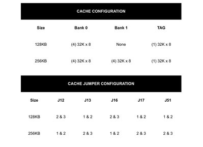

Ordered cache chips of this type UM61m256K-15 32x8.
They fit, bit are not detected by the system.
Got 9 of them, and fitted 8 to cache sockets, and changed jumpers to 256kb cache.
Also installed 9nth to a socket on the other side of the riser boardwhere ISA cards are connected.
Think this is tag ram 2 socket. But when installing it, machine will not boot.
Remove it, and it boots up fine again.
I believe there is a tag ram socket more, that is label with a sticker that has the following written on it "BLFO".
This is a 20 pin socket.
I think I need to have both populated for cache to work, but can't find any information what sort of chip to get.
It is unknown everywhere I have seen.
Anybody have something similar, or happen to know what to get.
Have flashed it to latest bios(81 something).
Any ideas for a solution?

Reply 4 of 9, by Tiido
That 22pin chip is probably one of the special TAG RAM chips such as IDT6178S
Reply 5 of 9, by Intel486dx33
Yes, Should be jumpers 9 & 10
CACHE JUMPER CONFIGURATION
J9 , J10
128KB
Pins 1 & 2 closed
Pins 1 & 2 closed
256KB
Pins 2 & 3 closed
Pins 2 & 3 closed
To upgrade from 128KB cache to 256KB, you need to add four 28-pin modules (32K x 8, 25ns SRAM) and replace the existing TAG module with one 28-pin TAG (32K x 8, 20ns SRAM).
To upgrade from 0KB cache to 128KB or 256KB, you need to add either 4 (for 128KB) or 8 (for 256KB) 28-pin modules (32K x 8, 25ns). You also need to add a TAG module (32K x 8, 20 ns SRAM for 256KB or 8K x 8, 20 ns SRAM for 128KB)
Cache memory jumpers are preset at the factory for 0/128KB of cache. If you are installing 256KB, reset the jumpers by moving them forward to cover the two jumper pins.

Reply 6 of 9, by Viserion
I think I have done it correctly,regarding setting jumpers and so on, it's the 22 pin tag I think is the problem.
Did a quick search on ebay, and got 3 hits for IDT6178S.
One (and it had to be the cheapest one) has the wrong form factor, but I may try my luck with one of the others-
