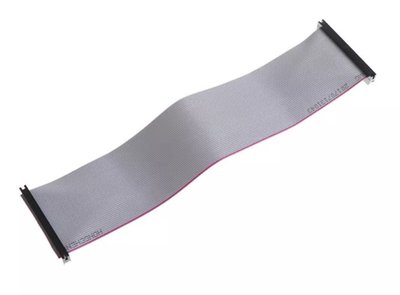

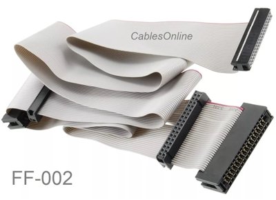

I am using both IDE connectors on the motherboard.
I use one for the hard-drive and the other for the CDROM drive.
If I set the CDROM drive to Master the CDROM will not work when I boot off a boor disk with CDROM support.
So I have the CDROM set to “Cable select” which works fine when I boot off the DOS boot disk.
And I have the hard-drive set to “Master/Single drive” which is the same setting.
I have swapped out everything , even the power supply.
Cables, drives, motherboards, PSU.
And I have the same problem.
