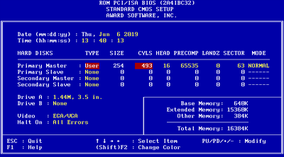

Reply 27 of 44, by Jo22
HanJammer wrote:
I use whatide.com recommended by Kev Parr who's a true english gentleman.
https://www.youtube.com/watch?v=G26cRjrt5Mg
Indeed, a very nice person, imho! 😀
There's one thing to take care of, though. Something that seems to be ignored, over and over again. 😢
The original CHS addressing (on IBM PC) is using a max of 1024 cylinders, 16 haeads, 63 sectors.
- But some BIOSes do count this way.. 0-1023, 0-15, 1-63.
So if whatide or any othe tool says there are "16" cylinders in total, it doesn't automatically mean you have to enter "16", but maybe "15".
So please better be careful here and double check. BIOSes using LBA and/or Large (E-CHS) *may* behave different.

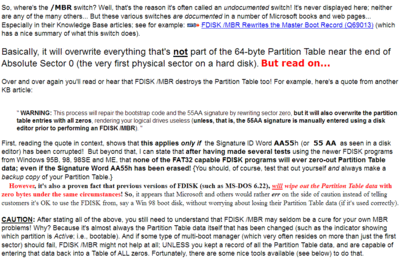

user33331 wrote:
Haven't tried again the FDISK \ MBR -trick.
Good luck! 😀
But please keep in mind that the switch doesn't work as it seems.
It will only work, if certain conditions are met. Also, the FAT16 (DOS 6.x) an FAT32 (DOS 7.10+) versions of FDISK behave different in detail..
It also is of little help in case of partition problems.´. To quote the author of the site linked below:
"you still need to understand that FDISK /MBR may seldom be a cure for your own MBR problems!
Why? Because it's almost always the Partition Table data itself that has been changed
Please keep that in mind. I've also attached the relevant part of the text.
More information: https://thestarman.pcministry.com/asm/mbr/FDISK.htm
Also, DOS by itself needs no partitions. It would also work in super floppy "mode"..
Having a partition could be better, though. Programs like disk tools and Win 3.11 might be confused it there's none.

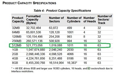

Reply 28 of 44, by user33331
Silicondrive manual:
PDF page 15:
https://www.semiconductorstore.com/pdf/newsit … xxx-3500_DS.pdf
It is either:
- Corrupted CF-card:
* due to swaps
* due to adapter
* due to powering OFF computer too frequently
*or such...
or
- Boot sector virus from old dos games downloaded online.
    111.61 KiB
    552 views
Reply 29 of 44, by Jo22
^ According to the table, the card has 1011 cylinders, 16 heads and 63 sectors.
1011x16x63 results in 1019088 sectors total, as noted in the table.
However, it doesn't say anything on how these are numbered, sadly. Or which addressing type is used. 🙁
In traditional CHS, the CMOS setting could be 1010 cyl, 15 heads and 63 sectors.
-> https://www.thomas-krenn.com/en/wiki/CHS_and_ … _Disk_Addresses

Reply 32 of 44, by Jo22
Don't despair. It's all a bit of a question of interpretation.
This table is fine, IMHO. 493 cylinder x 16 heads x 63 sectors = 496944 sectors in total.
However, if you multiply with 512 (bytes per sectors) it's 254435328 (bytes), as shown in the table.
- If you divide this by 1000, you get 254435,328 Kilobyte (~254MB, Megabyte)
- If you devide this by 1024, you get 248472 Kibibyte (same as old Kilobyte; ~242MiB, "Mebibyte")
HDD makers used to use 1000 instead of 1024 (RAM makers) for "Megabyte"..
This led to a bit of confusion. 😉
https://en.wikipedia.org/wiki/Kibibyte
Edit: Small edit. I'm not quite good at explaining things, I'm afraid.
Here's an article that covers the issue why HDD manufacturer used to use "1000" instead of "1024" when using Kilobyte/Megabyte.
- Please note that the matter might be different for semiconductor makers (RAM, Flash) - I just mention it here.
https://www.zdnet.com/article/attention-hard- … -is-1024-bytes/
Traditions aside, using "1000" also gives nicer numbers (= more Megabytes for less capacity).
Edit: I did some experimentation. You're lucky. It seems that old AMIBIOSes and AWARD BIOSES do handle things similar.
In your case, the CF card maker seems to have used "1000". Also, entering the values "as listed" in these BIOSes, gives the mentioned capacity.
So depending on your BIOS, you might be able to enter values as shown in the maker's table. Alternatively, just lower cylinders and heads by 1 and see.. 😀

Reply 33 of 44, by Jo22
Also, you don't need to use the exact values. They're virtual, anyway. It's all good if you use less , as well (stay within the max capacity).

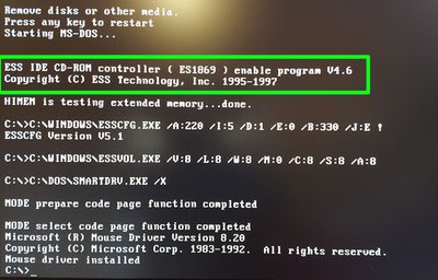

Reply 36 of 44, by user33331
Now I got the WD 512mb working again with FDISK, formatted it and installed dos6.22 again and win3.1.
SSD-C51MI-3800.
I don't swap the CF-card anymore and replace all odd dos game library(in case of boot sector viruses) and such...
I'm trying now really hard to get the sound card IDE-CD drive to work so I can use CD-ROMs.
+Sound card is ISA with a ES1869F-chip.( AK1868PNP from mfg.1996-1998 ) =No jumpers. ESS Audiodrive.
http://vogonsdrivers.com/getfile.php?fileid=690&menustate=0
ESS ES1869 driver for OS2 WIN31 WIN95 WINNT40
"CD driver"=ES1868.COM
What to write to AUTOEXEC.BAT and CONFIG.SYS to get D:\-drive up and showing ?
AOATAPI.SYS doesn't seem to work and says "no driver found error" when starting dos.
    104.99 KiB
    494 views
Reply 37 of 44, by Kubik
One of the command line parameters must be the one that enables IDE. You might need to move the ESS init to CONFIG.SYS so that you can load the ATAPI driver for CDROM as well - both needs to be in CONFIG.SYS.
Reply 38 of 44, by user33331
ESS 1869F Windows drivers creates automatically *DEVICE= C:\xxx\ES1868.COM* to CONFIG.SYS
Something like this:
CONFIG.SYS
DEVICE= C:\xxx\ES1868.COM /A:170 /I:9
AUTOEXEC.BAT
C:\DOS\MSCDEX.EXE /D:MSCD001 /V
Reply 39 of 44, by Jo22
Hm. Not sure, but maybe that enabler programs doesn't contain a CD-ROM driver itself, but only enables the IDE/ATAPI port on the sound card.
If so, it is required to load a separate IDE/ATAPI CD-ROM driver afterwards in config.sys (oakcdrom.sys etc)..
