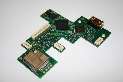

I keep seeing people mention FPGAs and them blowing out the budget for a cost-efficient device.
Personally, I never meant this task would require a Cyclone 10 GX bad boy, a Zynq or any chip costing over 100USD a piece. But is more about the overall cost of the finished unit, and people not wanting to accept the RPi isn't fitted to this sort of task.
About the XStation, you can find photos of an open unit in Google.
843.49 KiB
1364 views
As you can see, the Cyclone 10 used there is one of these used in the netduino usbkey like boards. Although magnitudes less expensive than a Zynq or an Spartan, still isn't cheap as CPLDs or other kind or cheaper controllers.

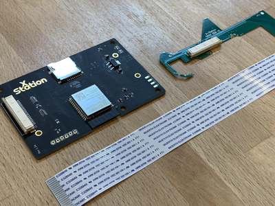

That's the PS1Digital, which takes the PS1 video signals and does video processing, and outputs HDMI.
The Xstation is just a board without a case or anything, but I can only find images of the top and no FPGAs are visible unless it's one of the really small chips that are unreadable.

There is an ESP32 on the board. That's a micro-controller, found on some Arduino.
So far I understand from docs... This board is just a dumb one with the wifi and the SD slot. It interfaces with the board which I posted, the one who finally implements the engine in the FPGA (along other functions), which in turn is connected to the Sony chips on the PS1 logic board. Ofc, I may be wrong, as there are a lot of products for consoles which do lots of things in one, and I don't know all of them.
Anyways, people may think would be too op for a PC ODE... But there are 2 things to have in count here.
*PS1 drive is a more direct interface which speeds PIO2 at much. PC ones, specially if you want to use this with more than 486 and Pentiums, aren't.
*You can use the ARM core in these chips to do all the copy protect emulation and analog audio you want in software, while keeping your FPGA logic for what it matters here, which is implement your ATA bridge in a way it can manage all the bus talking at the speed you expect from it. With it, you would also cut the RPi middleman.
I've read the ESP32 used for lights and wifi/comm stuff... Would be interesting see it used outside these applications.

The ESP32 gives you access to WiFi and Bluetooth while also having a programmable microcontroller. The one in the picture costs about $3.
My understanding is that it has an embedded RISC processor and isn't an FPGA.

So far I understand... This board is just a dumb one with the wifi and the SD slot. It interfaces with the board which I posted, the one who finally implements the engine in the FPGA (along other functions), which in turn is connected to the Sony chips on the PS1 logic board. Ofc, I may be wrong, as there are a lot of products for consoles which do lots of things in one, and I don't know all of them.
No, the board you see is the entire XStation. Many people do install both the XStation and PS1Digital so they have an ODE, and HDMI output on the same PS1. I believe the CD-ROM controller itself is on the PS1's mainboard and the XStation is just replacing the physical optical reading part of the drive.
