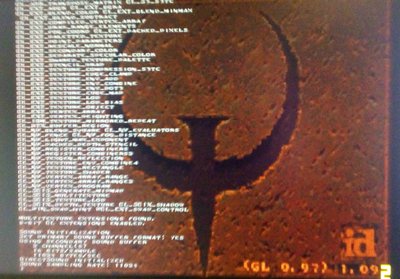

1) Win98SE (vanilla + drivers+IE6) - when i run Quake 1 - full, shareware, dos version, GLquake etc - i get freeze at the start of game loading a get info about video mode and SB settings and nothing.

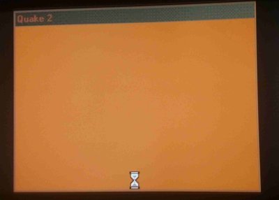

I got quite similar problem with Quake 2 demo - last single player - start the game, and freeze with loading cursor and incialization window - no error message.
I tried multiple Graphics card drivers 8.xx-21.xx version no change, multiple DirectX version - it probably doesnt matters, but i had to upgrade it anywhere from DX 6.1 to 8.1b.
Half life uplink demo - again start freeze, it has Quake 1 engine too.
I though that problem can be in sound card, but even after card removal its the same.. I Dos same Quake 1 installation is running fine, without sound (see 2nd problem).
I used vanilla Win98SE sb drivers, later i tried sbw9xup.exe (1997) but its the same. Its the same with or without ALI Chipset drivers - i used 2.13 as someone recommended.
95.69 KiB
1170 views
334.28 KiB
1169 views

After one more reinstall GLquake is now working - with Radeon and Geforce 3, but i still have problem with Q2 demo now its not freezing completly, but i still getting orange window as in screenshot above, which i cant now close.
Half-life 1 demo is now running to, at least in software and OpenGL.

I tried gog version of Quake II and its running, so problem is only with demo.
