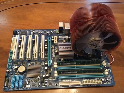

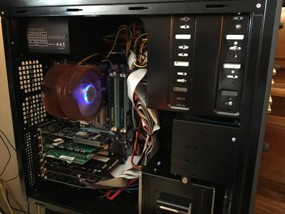

Reply 4 of 5, by Intel486dx33
I have a similar setup with Gigabyte GA-P43T-ES3G motherboard and Q9300. I never tried to over clock however.
The ALL copper base on the heatsinks are suppose to provide the best heat dispation.
