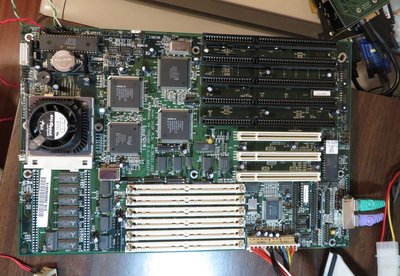

I'm looking for a BIOS update for a socket 4 motherboard I intend to install into a case. The motherboard is an Acer V12P socket 4 motherboard. The existing BIOS is v1.2R1.6 and I was hoping that someone had an update. The board is particularly fussy with PCI IDE bus mastering cards and graphic cards. I could not get, for example, the Promise Ultra100 or Ultra133 IDE controller cards to find any hard drives connected when installed on this motherboard. Same for my PCI SCSI 2940U2W and 2940W cards. Surprisingly, a Promise SATA150 TX2plus finds SATA and IDE drives and appears to boot fine. Though I must disable parity checking as I get errors on OS bootup otherwise.

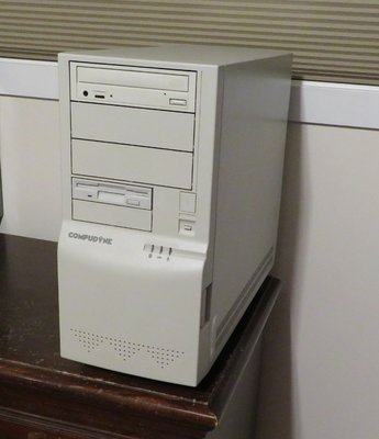

The case I sourced for the board originally housed an Acer V20, which is a VLB/PCI 486 motherboard with abnormally slow performance. Acer V20 486 PCI/VLB motherboard
As the V20T and V12P were released around a similar time frame, it is highly probably that the case is the same. I originally wanted to use my Intel Batman's Revenge Premiere/PCI socket 4 motherboard in this case, however the keyboard/mouse mini DINs don't quite line up with the Acer DIN ports on the case. Luckily, the V12P and Intel board yield similar performance, but with a slight edge for the Intel board, e.g. 25.9 fps vs. 27.3 fps in DOS Quake using a POD133.

Also, anyone happen to know what the case looks like for the Acer V12P?

Can't help much with the bios although the only version that's ever mentioned on forums is , like yours, v1.2R1.6 so perhaps there were no updates.
A correct case for the board is probably the one you have already, even though the V12P was used in both desktop and tower systems, based on FCC IDs
GQ8V12P-IDAB 1994-08-16 Tower Computer GQ8V12P-IDT 1994-04-29 Tower Computer GQ8V12P-ID3P 1994-04-29 Desktop Computer GQ8V12P-ID […]
GQ8V12P-IDU 1994-03-09 PCI Tower Computer
GQ8V20-IDAB 1994-05-25 Tower Computer
GQ8V20-ID3P 1994-05-25 Desktop Computer
If you look at the attached pictures in this eBay link https://www.ebay.com/itm/143260518165 you'll see an Acer branded V20-based system in the exact same case you have. Based on its FCC ID GQ8V20-IDAB it would be safe to assume that the equivalent V12P based system GQ8V12P-IDAB also used this case.

Would be nice to have an actual photo with the V12P sticker over the Compudyne logo though.
I'm tempted to modify my Intel Batman's Revenge board for a normal AT keyboard and plug it into this Acer case, but another part of me wants to keep it all Acer.

Well this motherboard looks pretty well built, not quite as solid as the Intel one, but pretty good. It has this interesting row of solder points, two parallel rows, around the SMD cache chips. Apparently, there was a very rare 512K cache upgrade module that would plug in there. I don't know if it was ever produced though. There is also a jumper setting for "Burst SRAM cache" I'm not sure what that is for, but the system wouldn't boot with the jumper set. I have to use "Standard SRAM cache".
The board could use a BIOS update. I wonder if the guys in Taiwan still have it somewhere.

Good to see another socket 4 system - the cache configuration is kinda funky from a spatial viewpoint. Not the common "arrow" one. If one were to solder connectors onto the board would it be possible to use a coast like cache configuration... albeit I guess the "format" is most likely proprietary.
