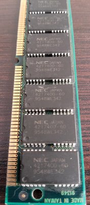

I have noticed that some DRAM chips have lower capacity than what they should have.
For example, this 72-pin SIMM has eight NEC 4217400-60 chips that should be 16MB but detects as 4MB only.

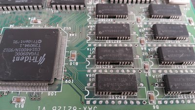

And the eight 4P4256DJ-M8 chips on the Trident TVGA8900C should be 1MB but detect as 256KB 😵
Any idea? 😕

Reply 1 of 9, by jaZz_KCS
The fact that both the GPU as well as the RAM stick get detected with a quarter of the total memory size makes me believe the system itself might be the culprit. You have tested these in multiple systems?
Some systems also only support DRAM to come in pairs or at at certain densities and are not able to allocate the full stick. This doesn't explain the GPU problem, though. But the card might be faulty.
The mainboard may simply not support the organisation of the memory module. It's totally normal that it then detects a different size. These chips are 4Mx4, the mainboard probably wants 1M, so it only detects 1/4 of the memory.
Detected by what? If the Trident is jumpered for 8-bit operation, it's auto-limited to 256 KB. Also, many older sysinfo tools always show 256 KB for VGA if they can't otherwise find out (or even try) how many video RAM is present.
Ah yes, the memory density is probably the problem here.
I found NSSI (v0.6.0) to have a very high chance of showing me the correct amount of graphics memory (at least in the vast majority of scenarios, depends on the system)
Probably mainboard does't support 16MB SIMMs. Try with Pentium era MB, not 486.
I have Genoa 8500VL 1MB VLB videocard based on CL-GD5426 chip. When I got it from the shelf, it showed 512 kilobytes. I replace all memory chip on it and then it shows 1 Mb. So, one of memory IC is bad.
I have lots of RAMs and motherboards. Only that single module has this problem 😕
Here's the video card:
https://stason.org/TULARC/pc/graphics-cards/I … -TVGA8900C.html
http://store.berkcom.com/Trident/JAX-8212B.php
I think you're right because it detects as 256K 8-bit but there's no jumper to set it as 16-bit 😵
