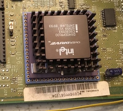

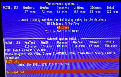

Why is my Intel 486dx4-100 running at 75mhz ?
I tried with the motherboard jumpers set for a 486sx and 486dx.
The computer is an IBM PS/1 that originally had a Intel 486dx-50 CPU.
CPU world reads this is a 100mhz CPU ( 33.3 x 3 )
Should this overdrive CPU make The adjustments automatically ?
All I have to do is plug the CPU in right ?
No jumper adjustments needed right ?

Reply 1 of 22, by alvaro84
Hm, if you haven't changed the FSB (trying to run it at 150MHz) it shouldn't even POST.

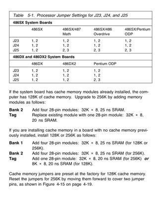

Reply 3 of 22, by Intel486dx33
These are the jumper settings I have available on the motherboard.
Reply 4 of 22, by derSammler
I guess you mean dx2-50..?
It makes fully sense then. The DX4 runs at three times the FSB, so 3x 25 MHz = 75 MHz. You need to raise the FSB to 33 MHz.

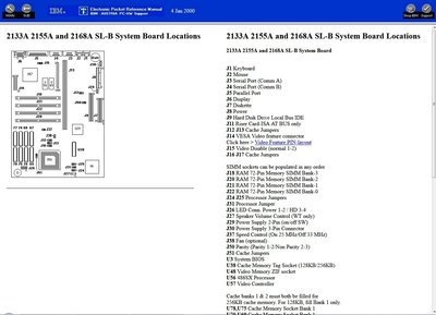

Reply 8 of 22, by Intel486dx33
rmay635703 wrote:
IBM PS/1 Change FSB […]
IBM PS/1 Change FSB
When I played around with my PS/1 I noted no FSB setting
These systems came in sx25 and sx33 so
I believe you need to change the clock crystal
That’s the motherboard manual I have been looking for. Thanks.

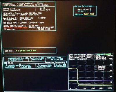

Reply 11 of 22, by Intel486dx33
keropi wrote:
what you need to do is install some L2 cache on this montherboard
Yes have been putting that off because I did not know the jumper settings but thanks to all your posts
I now have the correct manual with jumper setting.
I just put in 265kb of cache an it works fine.
And 64mb. Of ram.
Do you think it is okay to use this Intel 486dx4-100 Overdrice CPU at 75mhz ?
This overdrive CPU has a built in voltage regulator right? So I don’t need to worry about over voltage.
I have the motherboard jumpers set for a 486dx2 is that okay ?
The circuitry on the overdrive CPU compensates for that right ?
Or do I need to set it up for a 486sx or 486dx ?
Currently it is running stable in benchmarking.

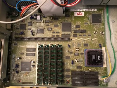

Reply 12 of 22, by SpectriaForce
The motherboard in that PS/1 probably only has a 25MHz FSB. It's called a PS/1 or PS/Valuepoint for a reason 😈
The multiplier setting should be 3x, but it's possible that the Overdrive CPU overrules the motherboard's multiplier setting, if I remember correctly. Other than that leave everything stock.

Reply 15 of 22, by keropi
it is no issue for the 100mhz overdrive to work at 75mhz - and yes these are 5v cpus so no problems there!
last time I checked there are no jumpers on these mobos to select the FSB so your system runs at 3x25mhz instead of 3x33mhz
I have a similar PS/1 system that came with 486sx25 and supposedly it also comes with sx33 but the FSB setting is soldered to the main chipset so when I upgraded with a DX2 cpu I ended up with a DX2/50mhz ... I am not that interested in changing the hard-coded FSB value tbh... but it's doable if you track down your chipset's datasheet (posted the 82C480 one in my 487sx socket thread)

Reply 17 of 22, by rmay635703
bakemono wrote:
what do J12, J13, and J16 do?
Set the cache size,
As stated the FSB is hard wired which takes a rewire or a new crystal

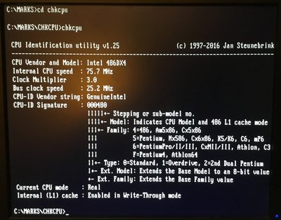

Reply 19 of 22, by Vegge
Did some more research based on my guess of J35, J36 and J37 that are close to the frequencygenerator. Came up with this.
254.08 KiB
300 views
So it seems that J37 switches between 25 and 33MHz bus.
