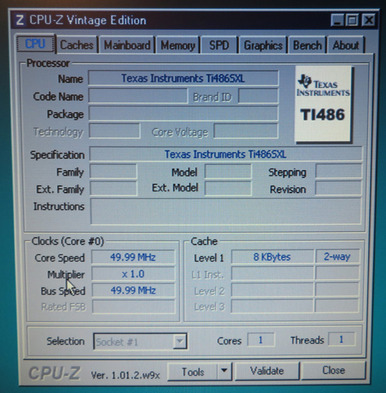

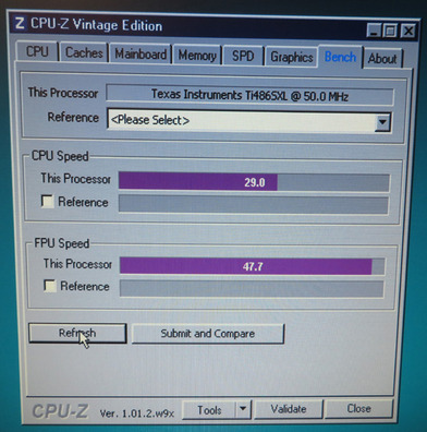

Test results with the SXL2-50 installed and running at 2x25=50 MHz and a Cyrix FasMath CX-83D87, running at 25 MHz.
CPU-Z is reporting the incorrect multiplier. Is CPU-Z able to read the Configuration Control Register 0 (aka, CCR0) bit 6? If it is set high (1) that means the 2x multiplier is active, if set low (0) the CPU is in 1x mode.
202.48 KiB
1272 views
Here are the benchmark results.

Reply 224 of 440, by CuPid
TechieDude wrote on 2020-04-16, 21:01:
Just tried it again in my Socket 5 PC. It's a success! Haven't tried to see if it still suffers from K5 crash yet, but I'll try soon.
Edited that out because it was unnecessary here. Sorry.
Great, thanks for the feedback.
feipoa wrote on 2020-04-17, 06:42:
Ah yes good point, I add this and update the binary. Thanks !
Your BIOS string is
40-0100-001131-00101111-080893-ALI1429
and according to https://www.wimsbios.com/aminumbers.jsp, 1131 is ECS. Weird.
I need a vacation.
Reply 226 of 440, by CuPid
I've added the 2x multiplier detection from CCR0. I wonder if the switch 1x / 2x works dynamically, do you have a tool that allows to change CCR0 ?

I have verified that CPU-Z shows the correct core speed and multiplier when I change the multiplier in software for the SXL2-50. However, when I disable the L1 cache entirely, CPU-Z is still reporting it as 8 KB, 2-way set associative. I think it should be greyed out entirely, or listed as "disabled".
Is CPU-Z able to display the graphic card information for VLB cards? Everything in the Graphics tab is greyed out.

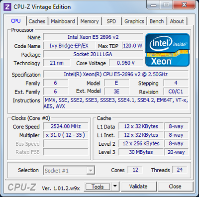

The latest CPUZ 9x had broken reporting for my 9980XE and many other systems. Reporting x12 and 30000MHz is clearly impossible and I see similar on most recent systems.
I also think IVB-E is 22nm rather than 21nm, see https://en.wikipedia.org/wiki/List_of_I ... erformance
Is CD bit of CCR0 set to 1 when L1 is disabled ?

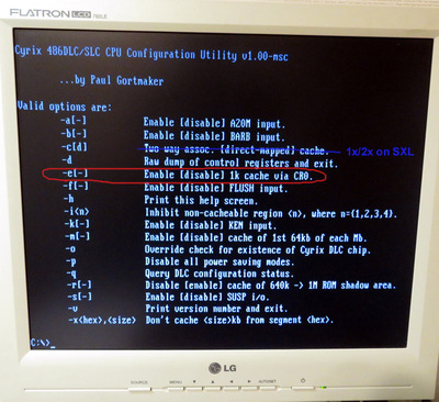

Reply 234 of 440, by feipoa
I don't know. This is my control screen:
214.29 KiB
1213 views
And these are the registers I can read from CTCHIP34:

I have a dozen more DLC/SXL software apps, but it would take some time to go through them all to see if any can read CR0.
EDIT: Note that CCR0 != CR0

feipoa wrote on 2020-04-17, 11:46:
Yes I just realize my mistake, CD is a bit of CR0, not CCR0.
