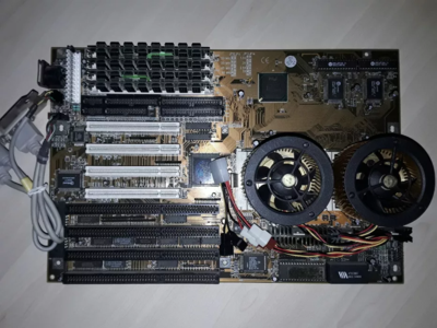

Hi. Can somebody tell me something about this MB?

Those are pretty ridiculous coolers for any Pentium MMX. Were they trying to air-condition the server room at the same time?
Reply 2 of 25, by dionb
The sticker on the southbridge is typically Soyo, if dual MMX, this has to be i430HX chipset, so this is almost certainly a Soyo 5TH0/H2/H5:
http://www.uncreativelabs.de/th99/m/S-T/34070.htm
Agreed that those Gorbs deserve a P3 that actually needs cooling. For P55C, they would work fine as passive heatsinks, just disconnect the fan.
Edit:
As for other stuff - it's an HX chipset. so max RAM 512MB. How much is cacheable depends on the tag RAMs, with one it can only cache 64MB, with two it can cache all 512MB. That pic shows two tags, so 512MB is cacheable.
Apart from that, max official CPU is P233MMX, but the chipset can easily handle 75MHz FSB and frequently also manages 83MHz. You can't do dual CPU on K6 or MII CPUs, but you can overclock those P200MMX beauties if you can figure out how to... it might be interesting to see what setting JP10 and JP11 both to open does. Depending on the PLL, it might do 55MHz (crap), 68MHz (not really interesting) or 75MHz (now we're talking).

P55C was SMP-capable, and any i430HX chipset will (with suitable VRM and BIOS support) do SMP with them. Years back I ran two myself on a P65UP5/C-P55T2D (weird backplane motherboard with two different CPU boards, either 2x So7 with i430HX chipset or 2x So8 with i440FX chipset). Apart from this Soyo board Asus also had a more 'normal' dual P55C-board, the P55T2P4D. They even still have it on their support site, with official support for P200MMX and P233MMX: https://www.asus.com/supportonly/PE-P55T2P4D/HelpDesk_CPU/
