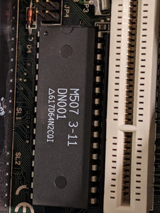

Reply 9 of 24, by appleg33k85
Wondering if anyone was able to get this chip to update, every flashing utility I've tired doesn't want to do it.
I'm thinking that a new ROM will need to be ordered but I'm not sure what I should get? I've attached a photo of the current one.
Reply 10 of 24, by PTherapist
appleg33k85 wrote on 2020-08-02, 04:09:
I got an Atmel 29C010 and wrote the newer BIOS to that with my MiniPro. Works great.

Reply 13 of 24, by TimmermanV
I had the same issue with this board. I used a Winbond W27C010 to replace the chip, also using the F59_MOD bios.
During boot it shows a warning message, something like "unknown flash chip detected", but so far it's running fine. Let's hope I don't run into any issues down the line. 😀
