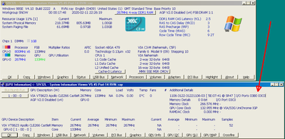

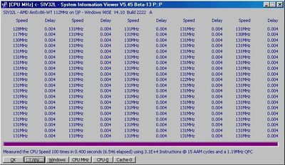

One last posting from me today 😁
I switched to the beta version (should not matter as you wrote)
and got
    108.31 KiB
    870 views
    SIV_P.txt
    194.38 KiB
    47 downloads
Reply 282 of 1037, by red-ray
CoffeeOne wrote on 2020-02-10, 20:39:
Thank you, this is exactly what I needed. Please replace SIV32L.exe 5.45 Beta-13 with the attached SIV32L.exe 5.45 GPU-PnP-14 test SIV and see what happens. So I can check how it does generate a new Menu->File->Save Local file and post it.
I pondered your GPU and have implemented generic support for PnP GPUs and assuming all the new code works SIV should report the GPU clocks .
Looking at [ CPU MHz ] then most of the time SIV got pretty close to 133MHz so I have adjusted the start-up speed measurement to try a few times and use the maximum. So I can check how long it takes to measure the speed then from a MS-DOS command window do SIV32L -DBGINI > SIV_DBGOUT.log and post SIV_DBGOUT.log.

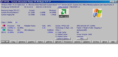

Thank you.
Test with the update, still 100% stable.
I see now values for GPU: clock and memory, nice.
Attached should be the 2 files, I added a postfix 2020-02-11 to both.
In the main window is still 112MHz displayed.

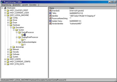

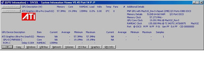

Reply 284 of 1037, by red-ray
CoffeeOne wrote on 2020-02-11, 15:54:
Thank you for checking out the new test SIV. I think I have found out why SIV comes up with 112 MHz, this is the speed Windows 98SE reports! If you look at HKLM\Hardware\Description\System\CentralProcessor\0 and in there I expect you will see ~MHz which will be a DWORD with a value of 112 or 0x70. Looking in the current log there is DBGINI 6710 CPU Speed of 112.000 MHz in 0.000 seconds 0.0E+0 Instructions @ 15 AAM cycles which is how I found this. With Port-14 there should be five of these lines, is there?
I have decided SIV should not trust Windows 98 so have reworked the code not to. Please try the attached SIV32L 5.45 Port-14 and generate new Menu->File->Save Local files.
I have also adjusted the GPU speed reporting to use CM_Get_Res_Des_Data(), etc. as there is no PCI config space to read the I/O Port from. Below is a screen shot showing this for a PCI GPU, but it should also work for your EISA GPU and I suspect PnP ISA GPUs on all of W9x + W2K and later, it will not work on NT4.
I am too am working on a new panel to report the EISA slots, but at the moment it does not work and crashes out on my W98SE system, so don't try Menu->System->ISA Bus.
file.php?id=76730
    33.78 KiB
    824 views
    [GPU Info] showing I/O Ports
Reply 285 of 1037, by CoffeeOne
red-ray wrote on 2020-02-11, 23:21:
Thank you for checking out the new test SIV. I think I have found out why SIV comes up with 112 MHz, this is the speed Windows 9 […]
file.php?id=76730
Hi,
you are right about the registry entry, I will add a screenshot.
GPU Info gives more realistic values now, but I don't know if the values are correct. Before it had memory speed 83MHz, would have been incredible fast 😁
I will add a screenshot + the Save Local File.
Waiting for the EISA page 😀 Will the SCSI drives show up, too?

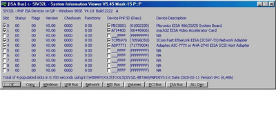

Thx. It seems, that will be still not the final version.

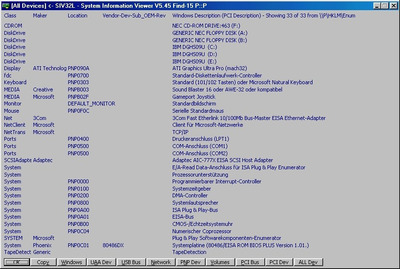

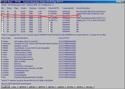

Menu ISA bus is here now.

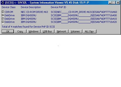

What I meant before "to show SCSI disks" was just listing it.
Now they are neither visible in "drives" nor under "scsi".
Only in "All devices" they show up.
    102.7 KiB
    785 views
    61.9 KiB
    785 views
Reply 290 of 1037, by red-ray
CoffeeOne wrote on 2020-02-12, 21:35:
It seems, that will be still not the final version. Only in "All devices" they show up.
Thank you, please try the attached SIV32L 5.45 Mask-15 which I suspect will improve [ISA Bus]. On the initial screen it should now display Micronics EISA 486/33/25 System Board and the L2 Cache Size should be there.
The disks should also be on [Device Tree] and I suspect a few other panels, search the save file to find which.

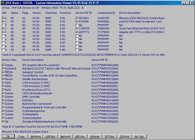

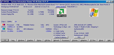

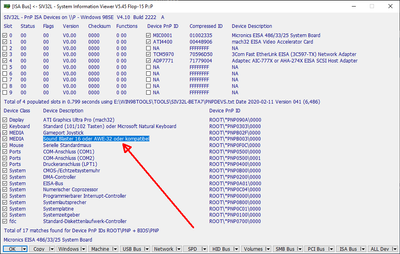

Awesome.
Some minor points: 256kB is still not detected /shown.
The sound blaster 16 is not shown under ISA devices (the only ISA card in the system. All the EISA cards are shown).

Reply 292 of 1037, by red-ray
CoffeeOne wrote on 2020-02-13, 00:05:
Thank you, please try the attached SIV32L 5.45 Disk-15 which should have the L2 cache and tidy [ ISA Bus ], may I have a new save please?
I will have a look to see what else I should add to [ ISA Bus ].
Edit 1: I spotted the logo was suboptimal so adjusted it for SIV32L 5.45 Logo-15 😀
Edit 2: I added a few more things for SIV32L 5.45 Disk-15 , you should be able to guess what 😀

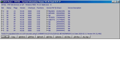

Reply 293 of 1037, by CoffeeOne
red-ray wrote on 2020-02-13, 02:07:
Thank you, please try the attached SIV32L 5.45 Disk-15 which should have the L2 cache and tidy [ ISA Bus ], may I have a new sa […]
Thx. Close to perfect I would say.
Only the soundblaster 16 is still not listed in isa bus (it is in slot2).
Drives are now listed under drives and under scsi, very good.
About sound blaster 16: It is configured in the eisa config, but it's not working in ISA plug and play mode as far as I know.
I will soon test your tool with my other 486-EISA machine, it has only EISA slots, too. Cards inside: 2 EISA NICs, 1 EISA SCSI Adaptec, onboard EISA SCSI, 1 EISA Graphics card Compaq 1024/E. + ISA Sound blaster 16. The sound blaster 16 is listed in EISA config, too, but this machine works with ISA plug and play, it's a ISA PnP card ....
We will see later 😉

I noticed the floppies were missing from [Drives] so added them, please may I have a new save file generated by the attached SIV32L 5.45 Flop-15?
I am planning to release SIV 5.45 tomorrow, so if you wish it to fully support your other EISA system the sooner I get a save file from it the better the odds are 😀.
Hi, thx again.
Floppy drives are now listed in "Drives".
Yes, the soundblaster device is listed as MEDIA. But it would be nice if the location would be shown under ISA slots, too.
SIV would show the complete EISA configuration. But as I said it's minor (or better "nice to have")
I also attach the EISA configuration file that I used for the sound blaster 16, maybe it's useful, I don't know.
I am afraid, I can't send now the info for the other machine, my Windows 98SE setup there is not finished (it's fresh installed, too)
But maybe I can do it today.
EDIT: The sound blaster 16 is in slot 2.

Reply 296 of 1037, by red-ray
CoffeeOne wrote on 2020-02-13, 18:06:
Thank you and I feel I can't improve things with the EISA slot reporting given what I currently know. The Compressed ID is read from the hardware, but when SIV reads this for Slot two it's FFFFFFFF. It's possible that on Windows NT SIV would report slot 2, it all depends on what HalGetBusDataByOffset( EisaConfiguration,...) returns. Maybe once I have released 5.45 we can dump some blocks on I/O Space and see if the PnP ID is available. It would be helpful to get the SIV save files from any EISA system running NT, do you know of any forum member who has one?
I have been looking at how [Cache-0 Latency] does in the save files, sometimes it deduces the L2 cache as 256KB and other times not. Is the whole of the 64MB cacheable?, I suspect not.

Reply 297 of 1037, by CoffeeOne
red-ray wrote on 2020-02-13, 18:27:
I have been looking at how [Cache-0 Latency] in the save files, sometimes it deduces the L2 cache as 256KB and other times not. Is the whole of the 64MB cacheable?, I suspect not.
Hello,
I just saw, that it's the same for hwinfo, it also reads out only the mainboard, slot 1, slot3, slot4 and slot 2 is missing.
But I did not complain about it, I forgot to do it 😁
As far as I know the full 64MB are cacheable. The mainboard has 3 times 16kx4 tag rams.
But I try to find it out, but I must rely on the output of the used tools ....
Reply 298 of 1037, by Mumak
This is because the SB16 is ISA, hence it doesn't support the extended EISA features that would allow identification via this interface.
The Non-PnP SB16 version can be detected directly only by testing various I/O locations. Such detection might work more-less in DOS when no other applications/drivers are talking to it, but under Windows this would be dangerous as the detection could intefer with the SB16 driver or other devices located at those I/O ranges.
The whole 64MB is cacheable by L2 cache according to ctcm 1.6 (from the german ct magazine, Andreas Stiller)
