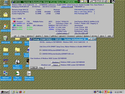

Reply 760 of 1037, by drosse1meyer
red-ray,
please see attached. Non-mmx P166, s3 virge, voodoo1, 64 mb, win98se.
regards
Reply 761 of 1037, by red-ray
drosse1meyer wrote on 2021-08-17, 02:20:
Thank you for the report in which all looks good to me. From the screen shot I can see SIV did the setup needed to report disk SMART information, once the system was rebooted did the disk get reported on Menu->Devices->SMART Drives?
The monitor PnP ID looks to be EXN0000, but this is not in MONDEVS.txt. Looking at Menu->System->Monitors it's 2009 vintage and 17.1", can you tell me what it is so I can add it?
Reply 762 of 1037, by drosse1meyer
red-ray wrote on 2021-08-17, 07:52:
Hi
Yes, after a reboot it showed whatever scant information the sd to ide adapter provides
Re: monitor - you may want to ignore this, i am running my vga through an extron scaler which then outputs over DVI to a modern LCD
Also the hover tooltip complains about COMCTL or something on my system
Thanks
Reply 763 of 1037, by red-ray
drosse1meyer wrote on 2021-08-17, 19:05:
OK and without knowing the the exact tooltip text I will have to guess. Your system has COMCTL32 V5.00.2614.3500 whereas my 98SE system has V5.50.4522.1800 which I think came with IE6 SP1, I suspect if you also install this the tooltips will work as intended, do they?
I also suspect putting the attached COMCTL32.dll V5.50.4916.400 in the SIV folder would work.
    COMCTL32.zip
    264.74 KiB
    39 downloads
Reply 764 of 1037, by drosse1meyer
red-ray wrote on 2021-08-17, 23:24:
Thanks. Placing the .dll in the same dir didn't fix it. The version in c:\windows\system is the same as what you attached too.
That link to IE6 is a web stub which fails unsurprisingly, so I used a full install instead : http://www.oldversion.com/windows/internet-explorer/
After updating to IE6, it is now showing tool tips! Hurray! (Incidentally, all versions of comctl32.dll appear to be the same as before install, so there must have been some other quirky windows thing going on, perhaps a support file wasn't properly registered. smh)

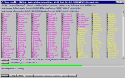

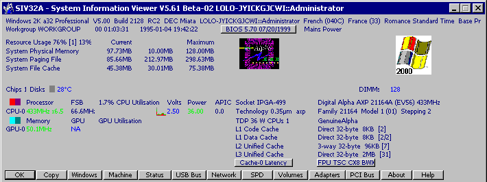

Reply 768 of 1037, by lolo799
Decided to play a bit with my pws433a:
9.95 KiB
819 views
6.22 KiB
No downloads
6.7 KiB
No downloads
    siv-miata.zip
    171.37 KiB
    40 downloads
    Full report
Reply 769 of 1037, by red-ray
lolo799 wrote on 2021-09-03, 16:28:
Thank you for the report, I feel SIV did OK however it could do better and the attached SIV32A.zip should so please will you try it.
SIV had support for my PWS600 which is a MiataGL whereas your PWS433 is a Miata.
Does your PWS433 have a L3 cache? Looking at Menu->Hardware->Cache Latency->Cache-0 I suspect not.
I noticed you just used the release SIV32A.zip which is an add-on for SIV32L.zip and does not contain all the xxxdevs.txt files in order to keep the file size below the Vogons 5MB limit. Given this you should copy the missing .TXT files to your Alpha so that such as [PCI Bus] can report the device names.

Reply 776 of 1037, by lolo799
red-ray wrote on 2021-09-07, 07:56:
I am not 100% sure which section 157 is, I think it's [my-ip-address] and assuming so it should timeout after about 30 seconds. What happens with Menu->TCP/IP->My IP Address ?
In general if there is an issue with a section you can do Menu->File->Save->Save Selected and deselect that section before pressing [Start].
157 is country, after that it's network related.
The onboard Dec ethernet card stopped responding at all in Windows 2000 and network related services couldn't start anymore.

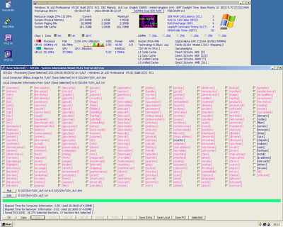

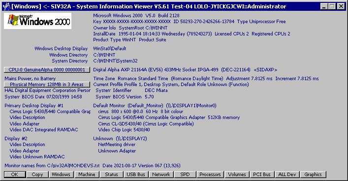

Reply 778 of 1037, by lolo799

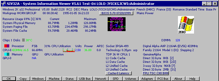

With the Test-04 version:
10 KiB
723 views
11.58 KiB
723 views
18.34 KiB
723 views
SIV_LOLO-JYICKGJCWI.zip
41.88 KiB
36 downloads
I'll put in the Mystique card in next time I use it.
Reply 779 of 1037, by red-ray
lolo799 wrote on 2021-09-07, 10:26:
Thank you for running the test, but you did not do Menu->File->Save->Save Selected, deselect [Country] and then press [Start] as I asked, please try again.
file.php?id=118756
I tried Test-04 on my PWS 600au and [country] worked so I am pondering why it stalled on your system. When it stalled what % CPU time was SIV32A using?
SIV did not work as I hoped as think SIVA32.sys was deleted/went missing from C:\SIV32A\, what happened to it? To check all the files are present look at Menu->Help->SIV Lookup which should report similar to as below, further such as [PCI Bus] reported as follows rather than the PCI Device Information because SIV was unable to find it's driver.
 SIV32A - running on \\LOLO-JYICKGJCWI - Windows 2K a32 Professional  V5.00  Build 2128  RC2
Unable to Open the SIV Kernel Driver \\.\SIVDRIVER
Error 2 The system cannot find the file specified.
file.php?id=118758
