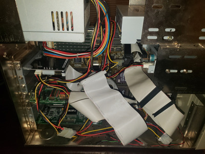

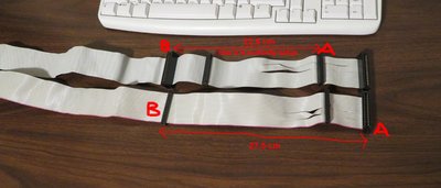

That's a pretty sweet dark grey CD-ROM drive. What's up with the 5.25" FDD though? Why not move it up a panel?
This is just how the computer came when it was given to me in 2001. Surprisingly, I never thought anything of it, but now that you mention it, I always place the 5.25" right under the CD-ROM, so I'll have to fix that. ... Wait <thinking hard now> I think the floppy cable wouldn't reach if I move the 5.25" up.
Reply 22 of 28, by feipoa
feipoa wrote:
Anonymous Coward wrote:
feipoa wrote:
The attachment SXL2-W95c_installation.jpg is no longer available
Yes, the issue was floppy cable length. In the attached photo, the top cable is being used in the SXL2 system. I have one with greater floppy drive port separation (the bottom photo), which will fit, but if I recall correctly, the A drive must be on the end of the cable, and B in the middle. The longer cable only has a 5.25" drive on the end cable, so I would be left with the A drive as the 5.25" and B drive as the 3.5". I don't really care for that type of configuration. The way around this is usually with a BIOS option called "swap floppy drives", but the BIOS on this board doesn't contain this feature.
It is possible that I have a floppy cable with a longer separation length the 5.25" in the middle position, but I'd have to pull out all my systems to check.

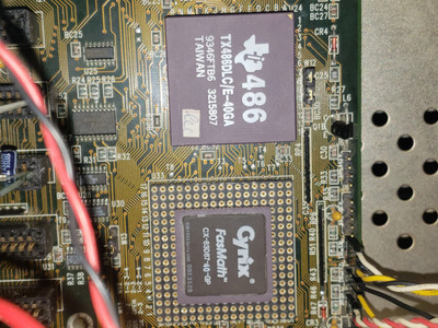

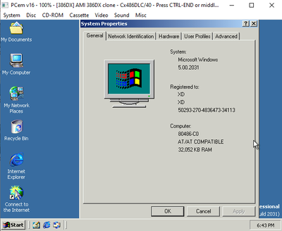

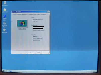

It is possible to run NT 5.0 (2000 Beta) on a 486DLC.
I've successfully installed Beta 2 Build 1906 on physical hardware. Here's the setup I used:
-FX-3000 motherboard
-TX486DLC/E-40GA
-Cyrix Fasmath CX-83D87-40-GP
-32mb ram
-128kb L2 cache
-Cirrus Logic GD5434 2mb, ISA video card
-Sound Blaster 16 CT4180
-64gb SD card in IDE adapter
Startup takes about 6 minutes, and it's very sluggish as expected though not totally unusable. I was also able to get sound working, and launch a few Windows games (eg. Freddi Fish series)
I also installed Beta 3 Build 2031 on PCem, but haven't tested on hardware yet. The startup time is 10 mins+.
Windows 2000 Final will not run. It bluescreens after setup finishes with "KMODE EXCEPTION NOT HANDLED". I've tried on both physical hardware and PCem.
For anybody else who wants to install NT5 on physical hardware, it will probably take more patience than you have. Be advised that if CHKDSK runs at any point, you will be stuck at a blank loading screen, and you'll have to start over. This means you have one shot at completing the last GUI portion of setup, and you cannot have more than 1 partition (having multiple triggered CHKDSK for me). Also, you should make a backup image of your hard drive/SD card as soon as the install finishes.
Finally, sound will not work on NT5 without a FPU (the same goes for 486SX's)
