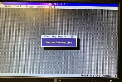

I have this motherboard: "LION COMPUTERS, INC. NICE GREEN-VL/ISA" http://www.win3x.org/uh19/motherboard/show/3461
Contaq 596a chipset w/ latest HWInfo 6.1.3 from this thread, May 4th 2021 build.
Locks up when trying to view "Mainboard Info" with a "Resetting CPU [Method 1]" message in the bottom right.
51.96 KiB
1194 views
I tried different switches -d -v -r -s with no luck.
I need to do a hardware reset to reboot.
