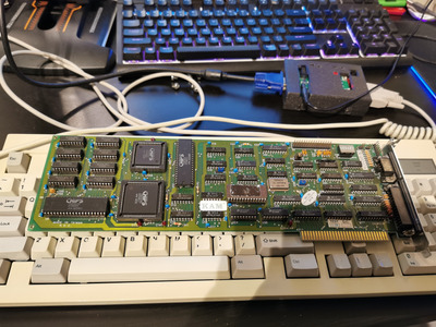

Help identifying this EGA card

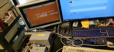

FAMICOMASTER wrote on 2019-10-23, 03:04:
Now that I have a color monitor, I've been able to identify a few more valid modes for CGA and what I believe to be EGA. […]
Things that cause a "flashing cursor but machine boots" on MDA can sometimes cause a display on a CGA monitor. Just to test, I put an MDA card in and sure enough when it displays a flashing cursor on MDA it boots on the CGA monitor about half the time.
Likewise, a "flashing cursor but machine boots" on CGA can sometimes cause it to display on the MDA monitor instead.
I'm sure there's EGA primary / secondary modes as well, but I don't have an EGA capable monitor right now.
Also, I still don't have a working keyboard. Not even my IBM Model M works on the AT clone anymore. Some keys failed.
Thanks for this thread and that you figured this card out, as I'm currently fighting with this one...

Reply 21 of 21, by HanJammer
| Type | SW1/1| SW1/2| SW1/3| SW1/4|
| EGA | Off | On | On | Off |
