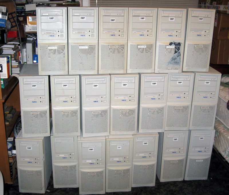

20 of these showed up at my house, I need to go through them and see what they have in the cases, hopefully all of them will POST
a few bezels didnt survive shipping but could be worse

Cardboard between them but one row of bezels was facing out, they are brittle so break easy
He didnt include extras, though I know he has some, will contact him again once I go through the rest of stuff

Reply 99 of 394, by Horun
I will take the 5th from left on top if you saved the broken grill parts. Easy fix if you did and am betting it has both cpu's and ram.
