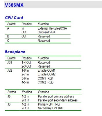

Reply 8 of 16, by Horun
There is no password reset jumper that I know of, you may have to short pins on the Dallas RTC to clear the cmos fully. The only jumpers listed for V386MX I can find are in this:
    38.39 KiB
    550 views

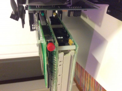

In the end I managed to work out how to reset the BIOS settings (including password). Removing the cmos battery didn't change anything. Then I started scanning the motherboard for nvram/rtc chips other than the classic Dallas. I didn't find any, although I could not find any data sheets for some of the ICs . Then I focused on the jumpers. None of the jumper blocks (probably around 15-20 or so) have any other marking than J2 or J11 etc. So it was basically a matter of trial and error trying each jumper and rebooting until I hit jackpot.
So here's the solution! There is a set of three jumper blocks on the backside corner of the cpu board, adjacent to the RAM daughterboard. The center block will reset the BIOS settings if jumpered during boot. It is the white jumper, just below the red reset button in the attached image. The only way to reach the block (or even see it!) is by removing the cpu board, or by removing the front part of the chassis.
