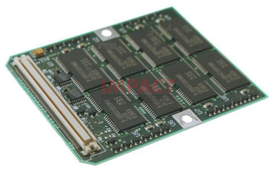

Is there any way for you to add more RAM to this laptop?
Reply 707 of 818, by vorob
Yes, I need to buy it 😀 But I guess it will be cheaper to buy another laptop where this expansion module will be in the box.

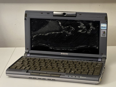

I've made a purchase - Sony Vaio C1 PictureBook PCG- C1VSX/K, 40 USD. Laptop + Floppy + CD-Drive + VGA Cable + Charger.
https://en.wikipedia.org/wiki/Sony_Vaio_C1_series
Now I'll have to replace the polarizer on LCD: https://youtu.be/zbrW7uUYpkw From one side it's possible and this dude fixed exactly my laptop. On another side, it looks like painstaking work...
I see that this laptop uses the same Yamaha chip as Toshiba 2805. But IRQ is 9 which is not available in DOOM for eg. I wonder if it can be fixed?

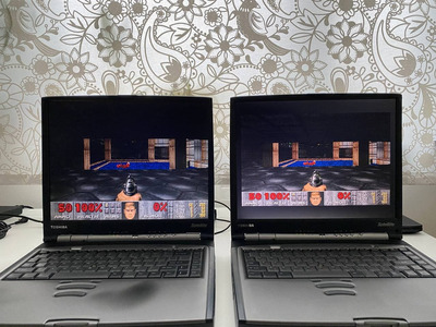

No idea about this particular laptop, but I've got Toshiba with S3, and it's doing awful scaling. The left one is GeForce 2 and the right one with S3.
