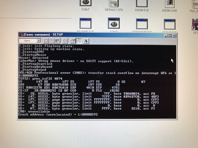

Full Throttle (1.0) and Little Big Adventure. Is there any known bugs with them? I’m trying LBA on 2805 and 5205 under Windows 98 and after intro video game just closes. In native DOS it works fine.
Full Throttle works fine both in Windows and native DOS, but it sometimes freezes for a 3~5 seconds. During cutscenes. It’s like HDD is entering sleep mode without activity and then game suddenly starts requesting data from it and that’s where freeze happening. But I’ve tried listening to laptop and HDD is working without sleep...
I remember having lots of problems with Full Throttle back in the day until I replaced the DOS4GW extender executable with another version. I think the CD itself had multiple versions of DOS4GW on it, maybe in a support directory. Might be worth a try.

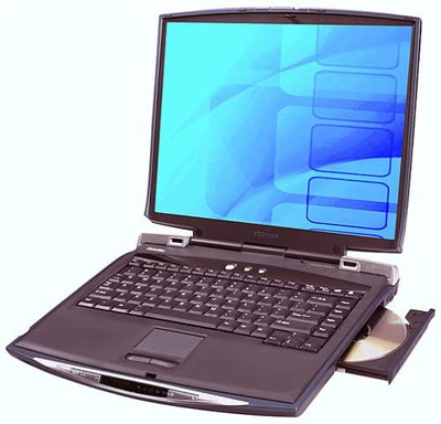

517W4DV7PGL._AC_.jpgDespite I've found a perfect retro laptop (Toshiba 2805), I'm currently busy with Toshiba 5205. It's a AC97 laptop with Geforce 5600Go. Reason? Gorgeous retina-like screen. It's a 1600x1200 resolution 15 inch panel with almost no sign of wear. It's bright, it's colorful and it has good black color.
Of course, Geforce FX 5600 can handle any Windows games, but what about DOS? I've installed Win 98 and tried several titles. Yamaha F753 allows General MIDI in Windows 98, so Duke, Blood, DOOM and so one sounds good. But few titles have some issues in some of their parts...
Moved to a dedicated thread: Fixing visual glitches on Toshiba 5205 (GF 5600Go) in DOS games under Win9x
Back to this machine. I’m spending happy hours with it playing old stuff, completed duke3d and blood, lba 1, full throttle and tiberium sun. Now I wanna go for doom and heretic. One problem, while other games works natively with sound and general midi, doom engine games won’t give me sound 🙁 I’m on WDM sound driver and Windows 98, duke3d works on 220 address, IRQ 5, DMA 1, but when I set the same stuff for doom game won’t launch. I’m getting this error:
203.81 KiB
806 views
Maybe there is a direction where to dig?
Music General MIDI works perfectly though.
