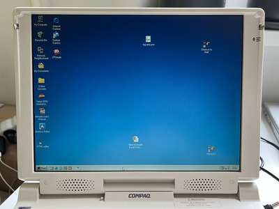

Reply 775 of 890, by vorob
Guys, I've got Compaq Armada 7792DM, what do you know bout it? If I'm correct it has hardware WaveTable Synth.
Perfect condition, but no battery (at all, need smth as a placeholder).

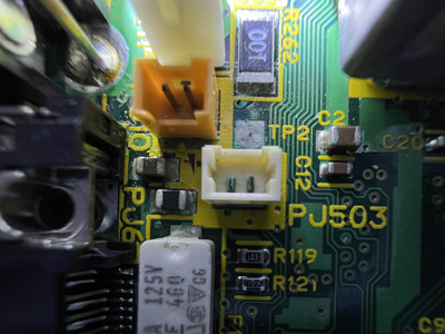

Reply 777 of 890, by Thermalwrong
That PSU behaviour looks like either a failed PSU, or a dead short on the board, that the PSU is detecting and resetting for. If you take it apart, the PSU plugs into a header near the front of the mainboard, you could disconnect it and check whether that header shows an open circuit or a short.
Often the 4xxCDT laptops will just turn on and do nothing, so at least a PSU fault is something new. You might need to check the mainboard front and back for any electrolyte that maybe could be causing a short?
Or if you have a bench PSU, you could hook up 15v to the header on the mainboard where the PSU plugs in, using the bench PSU in place of the internal PSU.
Try removing parts too, I recently got a Toshiba Satellite 540CDT that was not turning on, I took it apart a long way only to find out that it would only fail to start if the CD drive was installed. It turned out that there was a shorted MLCC capacitor in the CD-rom drive itself.

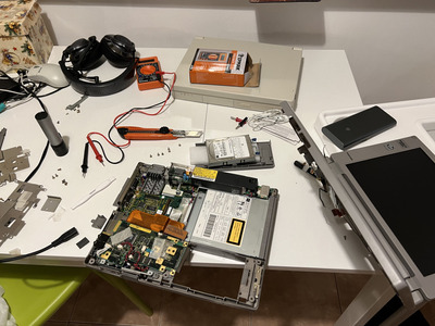

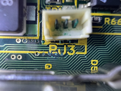

Reply 778 of 890, by vorob
Sadly it’s main board causing the issue. I took laptop apart, disconnected everything except motherboard and status panel, and still I get this, both on battery and ac. Tried without ac board, same.
Despite batteries were not leaked I found green signs not only on connector but also near it.
Guess I need to take the board out and clean it.

Reply 779 of 890, by DerBaum
vorob wrote on 2022-09-02, 05:21:
The batteries leak into the shrinkwrap and into the cables. You will not find leakage near the batteries but around the connector.
All Toshibas around that time have this problem…
