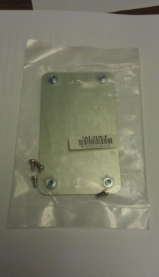

Reply 23 of 28, by PC Hoarder Patrol
Don't think you should have too much trouble finding the coolers but you'll also need matching retention brackets & springs and in particular the socket backplate(s) to fix them to, unless you're using a server chassis with these already built in. These are the backplates for your particular board / socket style, and they seem quite hard to track down (been looking for them myself).
268.1 KiB
154 views
