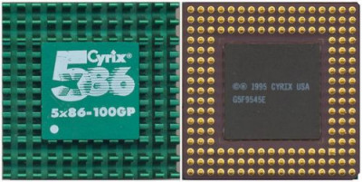

derSammler wrote on 2020-01-06, 17:34:
For that price and from China, I would not expect to get a real Cyrix 5x86. The pictures look fishy already, with odd horizontal scratch lines and the text "5x86-100GP" being wavy.
In that case they've done their best with the bottom, because that checks out perfectly (compare to this):
34.49 KiB
111 views
Those horizontal scratch lines look suspiciously like what you get if you slide a heatsink without thermal grease off horizontally, and not at all like a bad print job. Usually fakes are too smooth...
Tbh, the price of these things isn't high enough and the volumes are too small to make the risks of counterfeiting worthwhile. I'd be pretty certain this is the real deal. Whether it actually works is another matter, but given there's an eBay guarantee it's a risk worth taking.

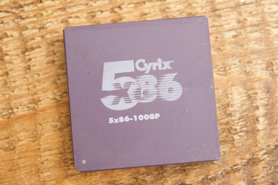

Reply 33 of 42, by mpe
Mine looks the same. Just the logo and model designation. But frankly I have no idea whether it started its life with the green heatsink or not.
157.13 KiB
104 views
