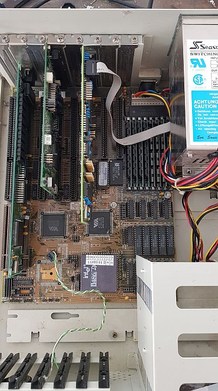

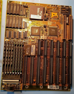

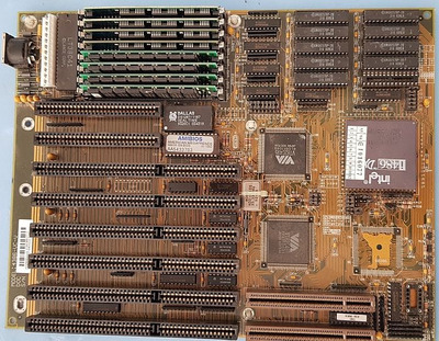

Now it had only been cranked up a few times out of storage in the last 20 yrs to make sure the 100mb HDD still had my data, but about 2 years ago it failed to boot completely for the first time - the RTC having expired. I tracked down the button-battery hack between pins 16 and 21 kindly referenced elsewhere on the Vogon forums... but found I can't actually remove the original Dallas DS1287 / 1187 RTC from the mbo. Needs a special tool I believe - or special knowledge as it doesn't actually look to me that it is socketted. I do all the "lego" side of upgrading physical components - the soldering side not so much. Is there anyone in the Brisbane area who might care to mentor me in this regard? Or has an alternative suggestion?

Regardless of the option you choose -- the cutting hack or the direct replacement, you'll need to do some soldering if the RTC is not socketed.
If you were to cut the sides of the RTC in-place, you would have to be extremely careful not to hit the motherboard. Most people use a Dremel to cut down to the traces you need to get to, but it can catch and fling the Dremel away from the intended cutting area and you'll hit the motherboard.
The safer option is to desolder the RTC from the board and either replace the RTC using a DIP socket with a new one (preferred), or you can remove the existing RTC to modify it and then reinstall (resolder) it in place.

That's marvellous information for me to get started with, thank you. I can't see where there might be either a line to indicate a socket arrangement - or little holes for a pincer tool to get in - and I used as much force as I dared to try to wriggle it free - no go.

PS finally worked out how to attach...
167.95 KiB
183 views
486 mobo isolated
33.17 KiB
183 views
486 mobo in situ
175.7 KiB
183 views
486 mobo rotated

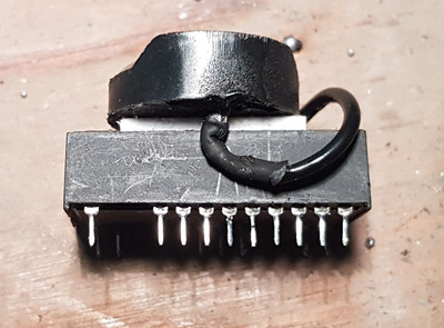

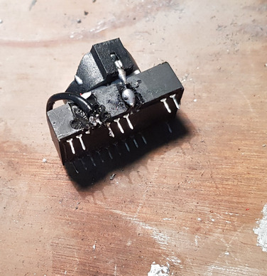

I have learned the hard way that the dremel bit can have untoward consequences. Attached are snaps of a "new" Dallas RTC that I performed the hack with - but inadvertently hacked off Pin 15. My attempts to resolder a new pin (with wire from paper clip) got messier and messier, as the 2nd shot shows after I was getting too cosy with the resin 🙁
Dread to think what I would (?) do over an unprotected motherboard...
Cheers
    463.66 KiB
    158 views
    RTC mod - ugly truth of missing "tooth"
    212.57 KiB
    158 views
    RTC mod, sunny side up
Reply 4 of 5, by Horun
Good job ! Is that some of that Double sticky foam under the battery holder ? Good idea !
Reply 5 of 5, by arobbo
Well spotted, Horun - 'twas indeed double-sided tape! Thanks for your kind comments - literally the first play with My First Dremel. *Next time* I do something like this I would embed the pins in a protective sponge etc - the plastic packaging was too restrictive, so I went "Commando". No such commando heroics if I were to attempt the on-board modifications wiretrap warmed about - even if I were to cover the circuit-board with high-density foam matting etc during the surgery, getting the angle of the dangle for successful connection to Pins 16 and 21 would be nigh on miraculous for me. I couldn't manage the pin replacement though I have "seen it" completed on various web sites.
