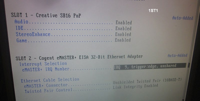

Yes, I got the 3Com 3c579 up and running. But currently no AUI 10baseT transceiver, but Windows 2000 was happy loading the card's driver.
At the moment, after finding the CFG file and drivers on a taiwanese university ftp server I try to add a Cogent E/Master III network card. But only NT driver, not 2000, so it would not work.
Reply 21 of 29, by 1ST1
The 3Com 3C579 network card is installed fine in Win 2000. But I can't test functionallity because first I would need a aui to 10base-t transceiver (just ordered one). I also found a CFG file for the Cogent E/Master-III (em932) card, but, I have no 2000 driver, only NT4 and that is not accepted by 2000.

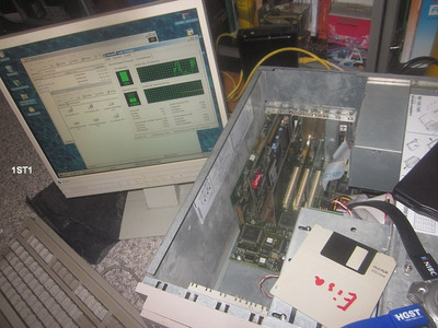

That are the beasts, both detected by EISA-Setup, 3Com fine in Win2K. I will not use them in the SNX, as they are reserved for the restauration of my two pcs. of Olivetti LSX 5020 486EISA machines...

OK, fine. So the 3Com EISA works under Windows 2000. Was it automatically detected by Windows 2000?
Reply 23 of 29, by 1ST1
No, I had to add it manually with the hardware assistant.

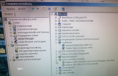

Now I have an Adaptec 1540CF in that PC as the 2nd controller. I prefered to have an EISA SCSI controller in there, but maybe not possible with the 1740 as no drivers available. The 1540CF works fine after adding it manually in the hardware assistant.

Reply 24 of 29, by CoffeeOne
1ST1 wrote on 2020-02-02, 00:46:
Perfect, so problem solved. Your Windows 2000 installation works correctly, no principle problem with EISA cards.

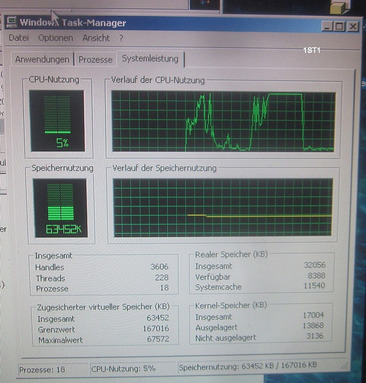

Reply 27 of 29, by 1ST1
Yes, you are right, I have overseen one digit... It is using more than 70MB, much is swapped out. But it's still running acceptable speed.
116.38 KiB
758 views
176.24 KiB
758 views
113.65 KiB
758 views
As soon I get another 32MB I'll add, or even more. Non cached memory is still better than no memory. And I plan to add a 2nd harddisk which will be used for Win97SE/DOS7.
