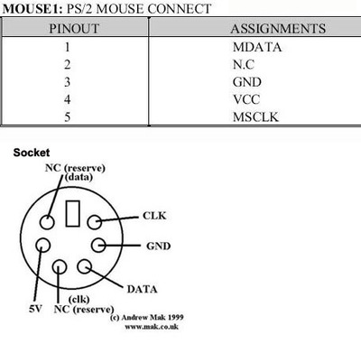

So I picked up this machine and probably should have done a little more research. Pretty sure the original owner used an old 486 case or something and threw this socket 7 mobo in it. I knew the ps/2 port was blocked but I didn't think it would be this much of a problem using something that isnt a serial ball mouse. I've looked into ps/2-serial compatible optical mice and haven't been able to find anything. Ive also looked into getting a kvm or something but every thing ive seen on ebay looks like giant piece of trash. So my other idea was to just cut/dremel the case. The problem with that is the cut would be at different depths. the mobo sits kinda far back from the back of this case. Any ideas? There isnt any real issue with having an awkwardly cut hole in the back of the case right? Using a ball mouse is ok for now but I'd like to use an optical mouse.I guess I could try to find a new case but I dunno what I'd be looking for to fit this motherboard. The motherboard is a biostar m5atc btw. If any one has any suggestions let me know.

Reply 4 of 9, by PARKE
That looks like a Biostar M5ATA motherboard and if so there is an extra 5 pin PS/2 connector sitting in the corner right next to the PS/2 housing. All you need then is a PS/2 bracket like this:
https://www.amazon.com/StarTech-com-MiniDIN-M … F/dp/B0002AFZV2

Reply 7 of 9, by FSOD
PARKE wrote on 2020-01-27, 06:15:
its a biostar M5ATC according to the printing on the motherboard. ill poke around in it tomorrow some time and see if I can find any ps/2 headers though. that would be great. I'll probably have to mod that bracket/cable though. I can't tell for sure but I think one of those wires is on the bottom row of that connector. Ive got a multi-meter and a soldering iron so it should be an easy fix.
edit: according to this manual i found its there like you said. i'll confirm it tomorrow. you might be a life saver man.
https://imgur.com/a/rR84paJ

Reply 8 of 9, by PARKE
FSOD wrote on 2020-01-27, 07:10:
That is the same layout in the two boards.
Yes, aftermarket mouse brackets need some tlc. But you do not need to solder. The wires in those Dupont plugs are held in place by a tiny plastic flap which you can lift with a needle to release the wire. You will have to figure out the correct position of the wires - the colours are not standardized. And be very careful with plugging the bracket into your mobo, incorrect positioning can burn a wire - happened to me twice.

Reply 9 of 9, by FSOD
hey guys just wanted to give you a little update. got the ps/2 bracket in there working and all good to go. had to rewire the dupont plug thing and it was a little tight plugging it in... but got every thing working relatively painlessly. thanks alot guys. no more ball mice for me.
