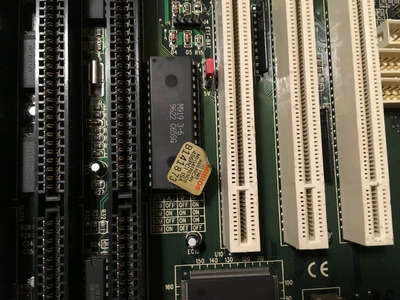

I have a M919 v3.4 B/F and it's eprom says: "M919 3-6, 9622 C65SG" under the AMIbios label (# B141873). The flash jumper JP2 is set for 12v on my board, your SST29EE010 runs on 5v as do many but may need 12v to actually program it (will have to read the datasheet). Sorry but I have no need to flash the rom but will check it with Uniflash v1.4 to see if it can detect the eeprom type. Will take a while as the board was just pulled out of antistatic bag because it was in storage.

Reply 4 of 11, by derSammler
BastlerMike wrote on 2020-01-28, 05:33:
original M919 bios chips with "M919..." print are not flashable.
I could flash the BIOS of my original M919 v3.4B/F just fine. Also, I've never seen an M919 with a BIOS chip that says "M919" on it. If it does, it's probably *not* original. The BIOS should be a flash chip (EEPROM) with an ordinary "AMIBIOS" sticker on it.
Reply 5 of 11, by Deksor
Just like they liked to remark chipsets, PCChips loved to remark bios chips. If you have an EPROM programmer like a TL866, you may be able to find out which chip it is : select a similar chip from the era, then there's a function to get the chip's id. If you find it, please send it to me.

Reply 6 of 11, by Horun
Deksor wrote on 2020-01-28, 14:21:

derSammler wrote on 2020-01-28, 12:13:
Here is a pic of the BIOS on my board, yes very odd to not have regular eeprom manufacture printing. The AMI sticker covered most of the odd M919 printing.
