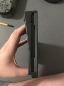

Hello everyone, I have aquired this laptop about year ago, the belt in floppy caddy broke, however Iam not able to open it even when screws are out.
Have anyone repaired it yet ? 😀
Thanks for any info. 😀

run your finger over the label to feel any voids under it. if you feel voids likely there are hidden screws. Rest of the screws are visible i guess.

I have done that, no signs of screws or holes under the label. 😒

Pry it apart at the seam on the horizontal plane with a cell phone opener plastic tool. It looks like a little spade tipped pry tool made of plastic. You can also use a very thin flathead screwdriver, but you'd have to be extremely careful not to mar the floppy enclosure plastic. There are likely tabs holding it together, and they can break easily.
