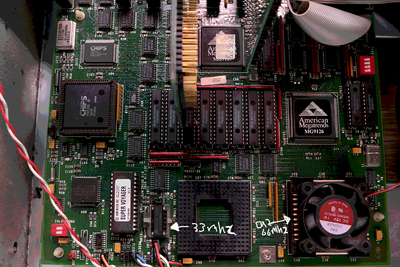

So the motherboard i have is a Series 50 Super voyager
https://arvutimuuseum.ee/th99/m/A-B/30737.htm
It has a 486DX2-66mhz processor in it but seems to be only running at 33mhz ( says so on screen during boot and benchmarks puts it at about 33mhz aswell).
I have put the jumpers correctly based on the link above, i have put in bios to start at high speed.
Turbo button on/off makes no difference
Now it does have a 33mhz occillator on board, its a SG51 series DIP package
https://www.datasheets360.com/pdf/-8956993113741826218
i have tried to replace it with a standard 66.666mhz metal can oscillator ( pinout seems same) but if i do it wont boot at all. Tested oscillator on oscilloscope and it outputs the correct 66.666
Any ideas?

That AMI Super Voyager is a VERY early 486 board. Makes me wonder if everything on it can actually support 33MHz...
According to TH99, J17 needs to be set to 1-2 for speeds over 20MHz. On the photo it looks like it's already set to that, is that the case?
Otherwise - do you have a 40MHz or 50MHz oscillator you could try? If neither works, it's probably something about the can. If at least one does, it's the speed of the 66MHz version something doesn't like.
Edit: the oscillator normally runs at *twice* the system bus speed. So for 33MHz bus, you need a 66MHz oscillator. OP is correctly trying a 66MHz oscillator for a 33MHz bus for a DX2 CPU that doubles that back up to 66MHz.
Reply 4 of 15, by RetroFletch
mpe wrote on 2020-01-28, 22:49:
DX2-66 is a clock doubling chip. So it uses 33 MHz bus and 66 MHz only internally. The BIOS might show 33 MHz at boot, but benchmarks should tell the difference. No special setup should be needed. Which benchmark did you run?
I tried winspeed wich put it at 33mhz or lower, i also tried SYSTEM SPEED TEST Version 4.78 wich put the cpu speed somewhere similar (below a DX2-50 )
if i run CHKCPU it does report cpu internal speed as 66mhz and bus speed at 33mhz.
Maybe the motherboard is just a crappy one? 😀

Reply 7 of 15, by mpe
dionb wrote on 2020-01-28, 22:55:
Yes. If only this was a 386 CPU with CLK2 input.
DX2-66 CPU needs 33 MHz on CLK input.
Blog|NexGen 586|S4

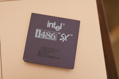

Most 486 boards with oscillators should have 1x clock. Unlike 386's. At least thats what CPUs expects.
However, my SX-16 feels a bit under-appreciated after your mentioning of SX-20 😀
download/file.php?mode=view&id=75544
Blog|NexGen 586|S4
Reply 10 of 15, by Deunan
RetroFletch wrote on 2020-01-28, 23:06:
I removed cpu and double and tripple checked its a DX2 😀
The reason I'm asking is because there were some reports of AMD DX4 (or DX5?) CPUs being sold as slower DX2. Either not deemed fully stable or just for filling the market gap. These CPUs would actually respond to the CLKMUL signal so an older socket with this signal not wired properly might confuse them. So I was wondering if maybe you have some odd CPU like that.
Since you have access to a scope, you can check the actual CPU clock frequency yourself: http://ps-2.kev009.com/eprmhtml/eprmx/h12203.htm
Test what is being delivered to pin C3, and since you have a 487 socket nearby and it should be 99% wired the same way, you can use that to stick the probe in.
Reply 11 of 15, by Deunan
mpe wrote on 2020-01-28, 23:19:
Huh. I stand corrected then. Perhaps it's some special version, I know Intel manufactured 386DX for a looong time with pitiful (on paper) clocks for military applications. This seems to be a '92 CPU - by that time Intel was mostly out of the woods with the 486 clock issues. I bet this chip can easily run at 25MHz.
