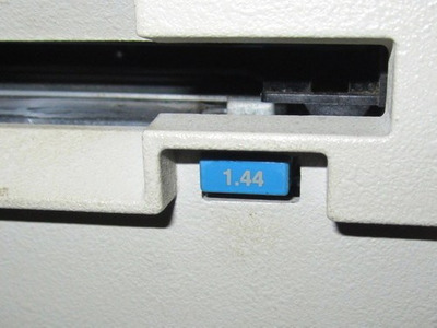

Reply 46 of 56, by pewpewpew
Horun wrote on 2020-02-13, 04:28:
Really ? Had a few old IBM's that had 720k and 360k drives. Hated the stupid blue eject button on the IBM's 720k's.
This style? This one's a RS/6000 which /maybe/ shares some hardware with PS/2. That's something I still need to look into.
[GAH! bloody images broken in a new way today. Let me post then try to add with an Edit...
