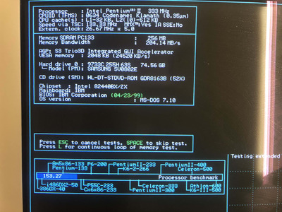

Today i did this test:
I set up the computer according to the table below as if it were a Pentium2 333Mhz (actually it is a P2 266)
and the result was what you see in the screnshoot below ...
Why???
Reply 8 of 32, by The Serpent Rider
That's infamous bug/feature of multiplier unlocked Pentium II.

Last time I checked, certain multiplier can somehow force some sort of "throttling". All utilities report 5x multiplier with 20-26 Mhz bus and the system overall feels very slow.

I disagree.
Speedsys readout is just messing up. My SetMul tool does not say such.
Pentium 2 Klamath core has a 2.0x multiplier setting with working L2 cache. Also one 2.0x setting which disables L2 cache.
Pentium 2 Deschutes core has only a 2.0x multiplier setting which disables L2 cache.
Pentium 2 Deschutes cores produced after a certain date are multiplier locked.
