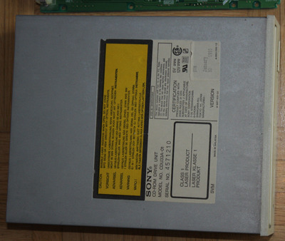

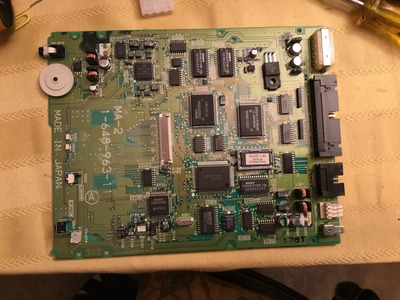

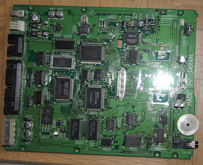

I have two Sony 2x CDU-33’s that need fixing.
The capacitors on the logic boards have burst and spread there junk all over the PCB.
Many capacitors have just fallen off.
Do you think these are worth fixing or not ?
They will need a complete PCB cleaning bath and replacing of all the capacitors.
That will be the only way to completely restore these to a reliable condition.

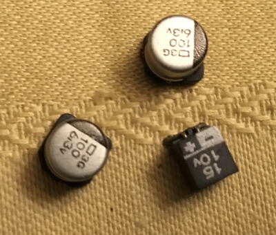

I don’t know what brand capacitors Sony used but they were cheap. They bursts and puked all over the PCB’s.
The gunk ate through the solder welds and the caps just fell off.
No wonder there are so few of these drives still around.
Anyone know what brand caps these are ?
Look at the photo above.
I have to look closer at the PCB’s.
The Pads maybe gone.

If it's like with some Macintoshes... You could try to substitute them with solid polymer capacitors... Though this is just a suggestion, I'm not really fluent in electronics.

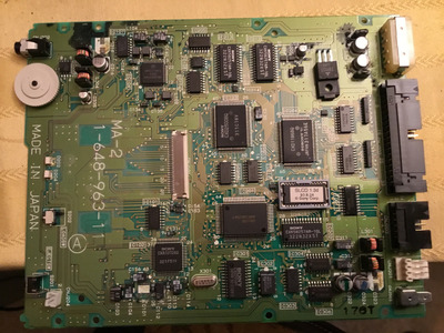

Reply 15 of 15, by Predator99
Thats mine. Bought new by myself (seems in 1995) and stored under good conditions.
No damage visible, no need to fix anything. Will check the drive if I still have the read errors I observed last time I tested it...
