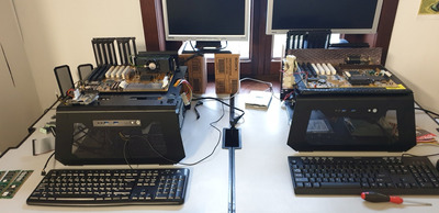

So I bought an Abit BX6 and an Abit LX6. After arriving home and putting them on my test benches, both do exactly the same, nothing at all. I tried with a CPU, without, with RAM and without, gpu, all loaded, nothing etc... nothing on the screen, no beeps, no nothing. I am using a standard power supply. (tested a few)
I'll include a picture of the boards.
These boards are pretty old naturally but really well cared after. The fact BOTH do exactly the same nothingness makes me suspect I am at fault and not the boards, somehow. I have little experience with motherboards of this era and maybe I am just doing something wrong?

Reply 8 of 16, by Munx
1. This might sound silly, are you sure the CPU is in all the way? I had some scares over the years where slot processors needed an extra push to be inserted properly.
2. Did you try other ram sticks or video cards? Certain boards just dont like certain ram configurations and video cards. Example - my Aopen 440bx board refuses to post with some ram sticks that work great in other boards.

Reply 10 of 16, by appiah4
amadeus777999 wrote on 2020-02-20, 14:03:
Connect a speaker & use a diagnose card.
Listen to this man. He speaks the true true.

Reply 14 of 16, by pentiumspeed
Yea. Speaker and diagnostic POST code card. And some quality memory modules, don't reuse what you have now. I do not trust these.

Reply 15 of 16, by oohms
Planet-Dune wrote on 2020-02-20, 12:12:
oohms wrote on 2020-02-20, 11:58:
I have consistent problem with ram, and a lot of boards are (or have become) very fussy about how the sticks are seated. With some boards, if i don't symetrically click in the sticks on both sides at the same time, it won't boot
I tried with no ram at all as well, it should at least give me either something on screen or if not, a beep right?
you won't get anything on the screen, but you will get beeps if it is the memory. A POST diagnostic card can also be of some help

Reply 16 of 16, by appiah4
No RAM or RAM in wrong bank will give you nothing but memory error beeps.
