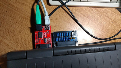

Reply 16 of 26, by matze79
PS/2 to Microsoft Serialmouse Adapter Converter / Updated First Post / Firmware Update added
160.51 KiB
790 views
GPL-2.0-or-later
Code is on Github.
maybe this item is listed soon on Serdashop to.
small bugs are currently being ruled out.
I've been looking at making my own active PS/2 to serial adapter with an arduino. Should be possible but I've not gotten it working yet. Best option if you don't want that level of work is to buy a serial optical mouse. They exist and can be found on eBay for somewhat acceptable prices. Note that you *don't* want a vintage Mouse Systems optical as they only work on a metallic mouse mat with grid lines. I love them, but if you don't want the mouse mat, they are not what you need.
