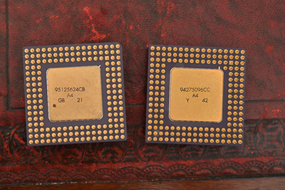

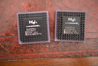

Reply 32 of 32, by mpe
The socket doesn't matter. The extra ODP pin (D4) doesn't matter either. If you have a ODP version, you can clip the pin and it would work just as well in normal socket as it has no electrical function. It just prevents non-technical people from installing it upside down which apparently happened a lot. Or at least makes it harder as some people would use hammer to get it in...
I don't judge anyone I also installed a 486 CPU wrong way which destroyed it (and the CPU socket).
ODPR on the left, ODP on the right:
246.71 KiB
567 views
307.26 KiB
567 views
ODP matters only in case you need to disable the soldered-in CPU. There is another pin called UP, which is one of regular pins (C11) in the inner section of the pins. This pin is defined as output on ODP CPU and input on all other newer 486 CPUs.
When you put ODP to the socket the signal on this pin is detected by the original CPU and it disables itself.
However many upgradeable systems have additional jumper so that the ODP CPU is not needed. And if the original CPU is in the socket you can always remove it.
