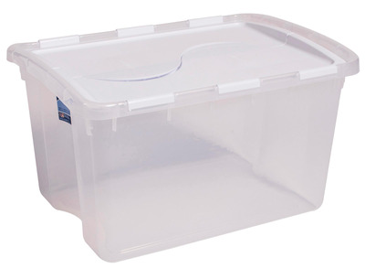

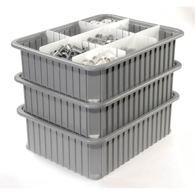

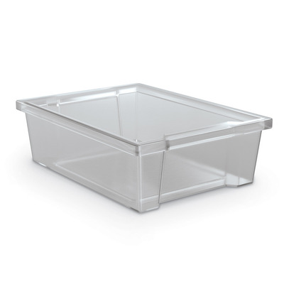

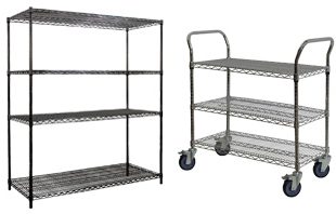

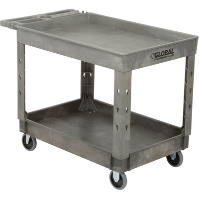

Here are some ideas.

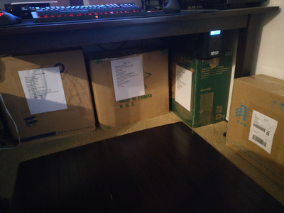

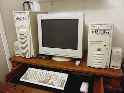

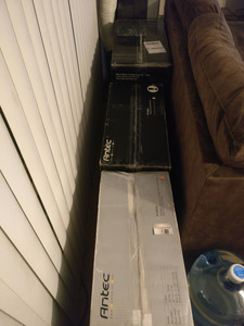

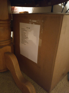

i am probably a weirdo but, the majority of my parts are stored in completed builds and then boxed up. i've built 10 retro machines in the last year. 2 of them i keep on my desk full time and covered when not in use. all the completed builds are put in plastic bags, boxed, sealed and labeled. i of course have a few boxes of miscellaneous parts, cpus, ram and stuff, nothing special but, even those are in esd bags. i'm not really a collector of parts that i have no use for so i like to get rid of them whenever possible. either way, i'm starting to run out of room in my 1 bedroom apartment. here's all 10 of them in their current state.
