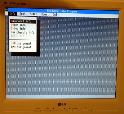

Reply 195 of 884, by feipoa

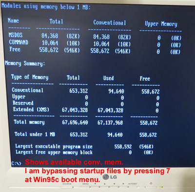

I've ran the latest hwinfo for DOS, v6.05, but had to bypass all my DOS startup files to avoid the memory error. Screenshot attached. Is 558,672 KB free of conventional memory sufficient? I ask because I encounted problems when using the software.
230.59 KiB
1536 views

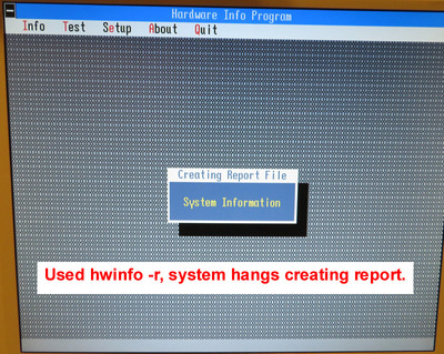

1) Creating the report file using hwingo.exe -r hangs the system. It has been sitting on this page for 10 minutes now. Pressing ESC does nothing. Upon reboot, I checked for a report file in the HWINFO directory, but none exists.
317.03 KiB
1536 views

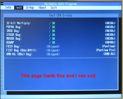

2) I am able to load the program and certain features work, namely,
199.74 KiB
1536 views
185.81 KiB
1536 views

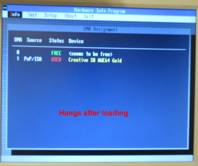

3) But when I try to run the IRQ Assignment, DMA info, Mainboard info, etc, the system locks up and I must hit the reset button on the case.
126.43 KiB
1536 views

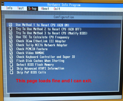

4) I was able to save the system configuration file, hwinfo.ini, and it contains,
[Configuration]
UseCPUIDmethod1=1
UseCPUIDmethod2=0
UseCPUIDmethod3=1
UseTSC=1
Check3ComELinkIII=1
CheckTulipNCC16=1
CheckPCMCIA=1
CheckVideoRAMDAC=1
Check8042=1
FlushDiskCaches=1
CheckFlash=0
SkipAdvATAPI=0
SkipPnPBIOS=0
So I'm left wondering if 558.6 KB of free conventional memory is sufficient to run all features of the program? If not, I don't know how to get more free without creating a boot disk for perhaps a lower version of DOS. The system contains a DTK PKM-0033s motherboard and sports a Cyrix 5x86-133/4x CPU. Hopefully I'll have better luck with the Windows version of HWINFO.

558 KB should be enough, but it also depends on system type and how much information is retrieved as memory is allocated dynamically. Anyway, if there would be a memory problem, then you'd get such a message from HWiNFO. So the hang here is something else..
Can you please try to run without -r parameter, manually open the Mainboard info page and take a picture where exactly it hangs?
You might also try to disable Method 1 and 3 to Reset the CPU if that will help.

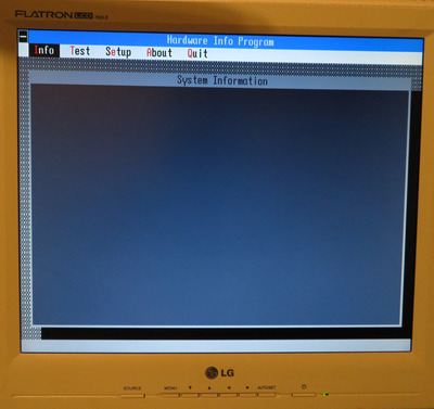

Reply 197 of 884, by feipoa
Here's the screenshots you requested.
Just before running Mainboard Info
327.16 KiB
1523 views
During the run of Mainboard Info
126.5 KiB
1523 views
And the resulting error
169.72 KiB
1523 views
The additional combinations I tried for the ini file were to set them all to 0, as in,
UseCPUIDmethod1=0
UseCPUIDmethod2=0
UseCPUIDmethod3=0
And to set just method 2 to 1, as in,
UseCPUIDmethod1=0
UseCPUIDmethod2=1
UseCPUIDmethod3=0
When just setting method 2 to 1, I was able to hit Q for Quit, and it appeared as if it was going to quit, but hangs on a blinking cursor on a black screen.
Note that the CPUID feature was not completely implemented in the Cyrix 5x86 series.
