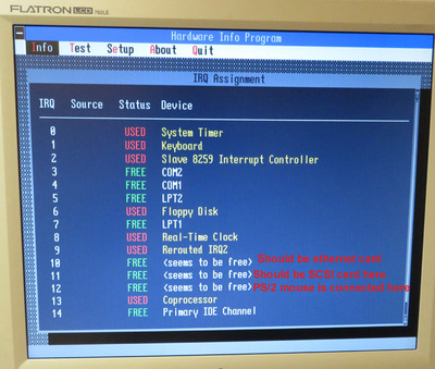

HWiNFO now shows the IRQ's that are consumed, and for the most part, still shows the proper IRQ's if EMM386 is loaded, except that IRQ 9 doesn't show the Ethernet card, just shows "rerouted from IRQ 2" if EMM386 loaded

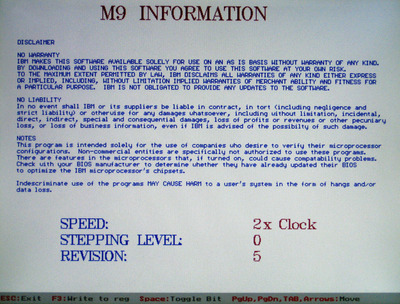

I've seen M1sc and M9, but not M0.9. Here is a screenshot from a utility produced by IBM for the 5x86c. I'd call it M9 / M1sc. but it is up to you. Also on this screenshot, you can see what IBM is calling the stepping/revision. Perhaps:
Perhaps name it like this?
CPU STEPPING: LEVEL 0, REV 5
I can see how someone not familiar with computer hardware might be confused if there isn't some alphabetic characters before the 0, but after the : Again, up to you. Just my 2 cents.
Yeah, I think its a good idea to take the multiplier information from DIR0. This is what Jan Steunebrink had to do as well with CHKCPU. If I recal right, if the user changes the multiplier in software (which we do on Vogons), then the multiplier as reported is messed up, as is the running speed. So, best take it from Device ID0 (DIR0).

I will keep the M0.9 as this comes from an official Cyrix document and with simple math M0.9 < M1 (6x86) 😀 I will also update the stepping to show as "Level 0, Rev 5".

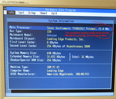

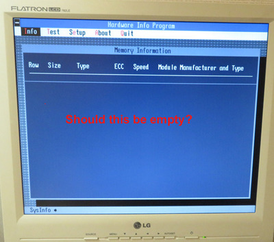

SXL2-50 run in DOS version of HWiNFO. Comments in the photos. Main issue I noticed is that probing the CPU is resetting CCR0 bit 6, so the CPU is getting put into 1x mode instead of 2x.

HWiNFO is not writing to CCR0, but I suppose this might be because of the RESET method attempted. Can you please try to disable all Method 1-3 to reset CPU in settings if that's causing it?

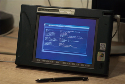

I just tried this out on my Stylistic 2300 tablet and almost everything seems to work.
Even the obscure NeoMagic 128XD graphics chip is correctly identified and the touchscreen shows up as an unidentified Fujitsu device. Nice.
It detects the audio chip as a SoundBlaster Pro (CT1335), although it really is an ES1879 sound chip.
It also says that there are no PCMCIA slots present, but there are two of them. The device makes a loud beep when they are initialized - that only happens in WIN98 and not in pure DOS mode, though. So they're probably just not activated in DOS and it's not HWInfo's fault.
Good job 😀
