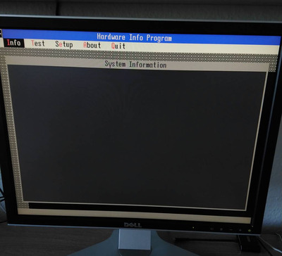

I tried to run Norton Diagnostics version 8.1. It gave me the same out of memory error that yours does, so I booted with the MS DOS boot floppy to just load himem. Program runs, but hangs right when it opens. This must be a pretty odd system to debug.
Reply 305 of 884, by schmatzler
Mumak wrote on 2020-04-18, 07:10:
Please try the latest build I posted here: Re: HWiNFO for DOS resurrected !
If it still hangs can you please take a picture so I can see where exactly it did ?
I did that, it hangs just immediately after opening the System Information tab.
