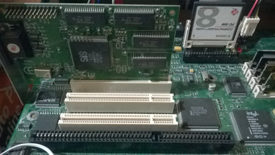

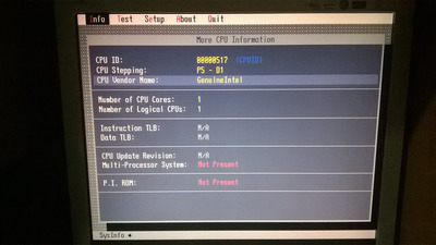

Eventually after several attempts I solved, I managed to boot the Pentium 60 from HD.
Obviously I connected the usual Cf of only 8MB with Dos 4.01 and I started the HWInfo program, it gave a problem creating the files via option -r -d, it stopped, but in any case it created both files (which I attach) .
I don't know the reason for the block but the PC has no additional cards other than the SiS VGA PCI, the integrated CL GD5434 should be disabled as it is not powered (P10 connector absent in the power supply).
the only thing present is the ISA POST CARD but I don't think it can disturb the functioning.
    854.81 KiB
    1432 views
    766.89 KiB
    1432 views
    714.94 KiB
    1432 views
    HWINFO P60.zip
    5.28 KiB
    53 downloads
